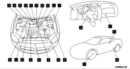

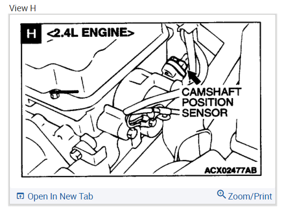

When completely stopped in drive, there is a vibration that shakes the entire car. When in park there is still a vibration, just less severe. While driving, the ride is smooth. The check engine light is on and it read that the crank and cam sensors were bad. I changed the crank sensor and the problem remains, the code reader still reads a bad cam sensor also. How do I replace it?
Jan 31, 2008 at 12:38 PM
MASTERTECHTIM
  • 4,750 POSTS
your vibration is most likely caused by a bad engine mount or transmission mount. when bad it lets the engine rest on the frame with no rubber in between thus causing a vibration. Here is the camshaft position sensor location so you can give it a try. Check out the diagrams (Below). Please let us know what happens.

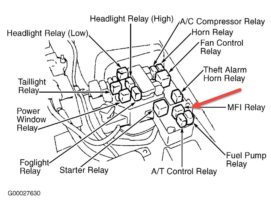

Car will start and run for about 4 seconds and shut off. I have checked with a test light the signal wire and power wires from both cam and crank pos sensors... What could be wrong?
Oct 19, 2020 at 9:19 AM (Merged)
HMAC300
  • 48,601 POSTS
try resetting security system if no manual look online for your car and reset
ALANP84
Hey, sorry for the delay. Reset didn't change a thing. Where is my mfi module?
HMAC300
  • 48,601 POSTS
there is no MFI module, there is a relay see pic,

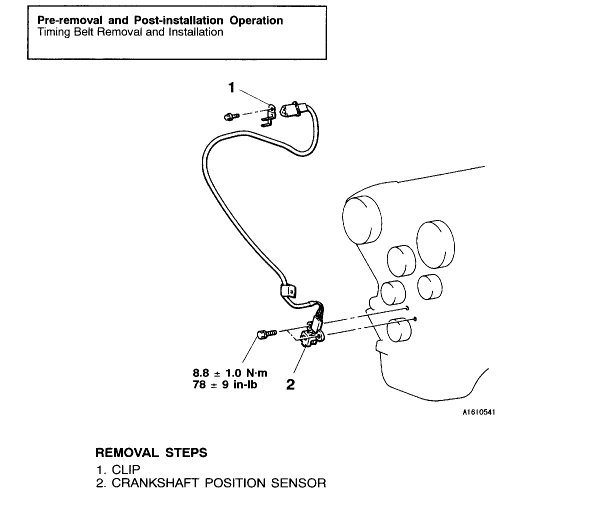

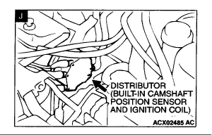

VEEROMO
I was wondering if I had a camshaft sensor position because I went to AutoZone they told me they did not. that this type of car did not have it it has a crankshaft. I need to step by step how to take off the crankshaft sensor position and put it back together and if I do have a camshaft sensor if you can please tell me exactly where it is at? I could not find it that is why I went to AutoZone they told me it did not come with this type of car I guess. thank you
STEVE W.
  • 15,349 POSTS
That engine has both a cam and crank sensor. But the cam sensor is not an individual part, it is built into the distributor. The crankshaft sensor is under the timing belt cover as shown in the picture. However, to diagnose either one for a problem you need some tools that most people do not have. Namely an oscilloscope and the special test harnesses that you use to get the signals from the sensors so you can connect the scope up for testing. Those let you watch both sensors to see if there is an issue with their timing or output relative to each other.

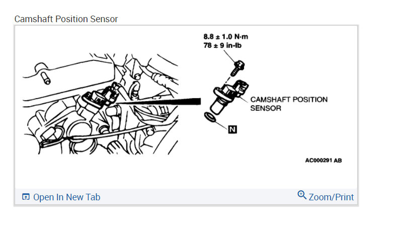

RJRACER
Were is the camshaft sensor located?
  • 75,992 POSTS
Camshaft Position Sensor Overall View
https://images.2carpros.com/forum/automotive_pictures/12900_cs1_3.jpg
