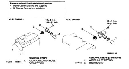

Where is the thermostat located on a 2001 Mitsubishi Eclipse GT V6 and is it easy to get to?
Aug 12, 2019 at 12:52 PM (Merged)
  • 75,992 POSTS
https://images.2carpros.com/forum/automotive_pictures/12900_stat_9.jpg
Removal service point <> radiator lower hose disconnection Place mating marks on the radiator lower hose and hose clamp before disconnection.

Where is the Thermostat located on a 2000 mitsubishi eclipse. I think its near the back by the battery but not sure.
Thanks
MRMIKIE
Your car has two radiator hoses, upper and lower. Follow the upper hose to the engine. The housing the hose is connected to houses the thermostat inside. Remove the hose and you will see some bolts on that housing, take those off and you should be able to get to the thermostat. Just remember to get a new gasket too.

where is the thermostat located and the heater core?
BLACKOP555
  • 10,386 POSTS
thermostat is located in the thermostat housing where the upper radiator hose meets the engine,
the heater core is located under the dash in the air ducts.
