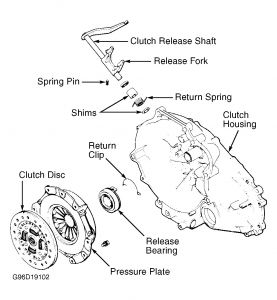

i am replacing the trans but the throw out bearing will not seperate this is a forward actuating clutch system i cant find any info on why it wont release

Hi there, The thrust is retained by a wire clip and when removed it should slide off the nose of the gear box.
https://images.2carpros.com/forum/automotive_pictures/61395_clutch_1.jpg
I hope this helps, if more information is required please re post. Mark (mhpautos)
