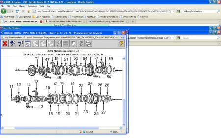

So Just had the clutch replaced w/ the bearing and come to find out it was also a bearing in the transmission making alot of the noise and i feared that. My tranny is rare and VERY expensive! So im wondering if the bearing is easy to get to and how hard the job would be?
Sep 13, 2010 at 5:22 PM
SATURNTECH9
  • 30,869 POSTS
Sorry to hear about the bad new's so is the transmission still out of the car?Also which bearing are they saying is bad?IS it the input shaft bearing that is bad that would be the shaft on the transmission that goes into the clutch?Let me know so we can figure out how big of job that would be.
Sep 13, 2010 at 6:10 PM
MUDGIRL13
  • 8 POSTS
Not too sure which bearing it is...the transmission is back in the car and the car is running but still is making the loud noise. Same as before just not as bad i guess but still pretty loud. Same as when i push the clutch in the noise goes away and then comes back when i let it out...how many bearings are in the transmission?
Sep 13, 2010 at 6:54 PM
SATURNTECH9
  • 30,869 POSTS
There are two support bearing on the input shaft one on each end my guess is the one on the side just under case where the shaft come's out to go into the clutch is bad.But without taking the transmission apart you never really know what is wrong or how bad the damage is.If it's just that bearing it shouldn't be too bad of a repair cost.Call out number 12 in the diagram i posted is the bearing i was telling you about.
https://images.2carpros.com/forum/automotive_pictures/416332_2001_mitsubishi_eclipse_trans_1.jpg
