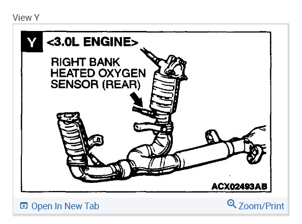

I have error code P0141 - "02 censor heater circuit malfunction Bank 1 Sensor 2". I need to know which 02 censor this is in relation to the car. Do you have a diagram or very good directions on exactly where this 02 censor is so I can change it out? Please advise. Thank you!

The bank 1 sensor 2 oxygen sensor is on the right side of the engine just below the catalytic converter. Here is a generic guide to help walk you thorught he steps with the location featured in the images below.

You have 4 of them
B1S2 is the O2S on the exhaust manifold close to the firewall follow it to the back should be right after the catalytic converter.
