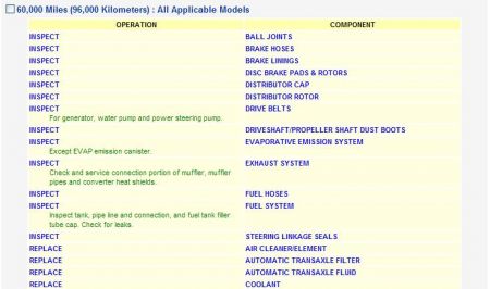

what services should be maintained to take care of for a 60000 mile mitsubishi eclipse spyder? And also what should be taken care for the transmission and electrical problems of a mitsubishi eclipse? because i heard the mistubishi's easily wear off the transmission and electrical problem.

I did not see any techincal service bulletin (TSB) or recall about the transmission or electrical issues for this vehicle.
