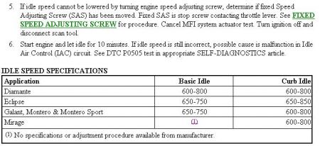

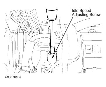

ZACKMAN
  • 4,202 POSTS
https://www.2carpros.com/forum/automotive_pictures/55316_00eclipseidle_1.jpg
https://www.2carpros.com/forum/automotive_pictures/55316_00eclipseidle_2.jpg
+1
