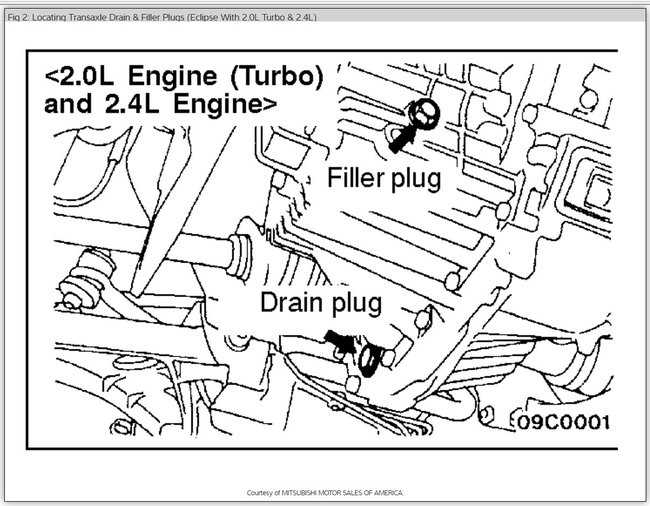

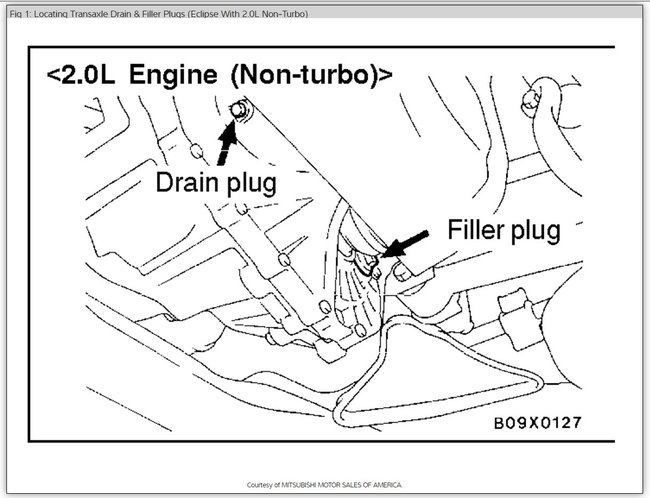

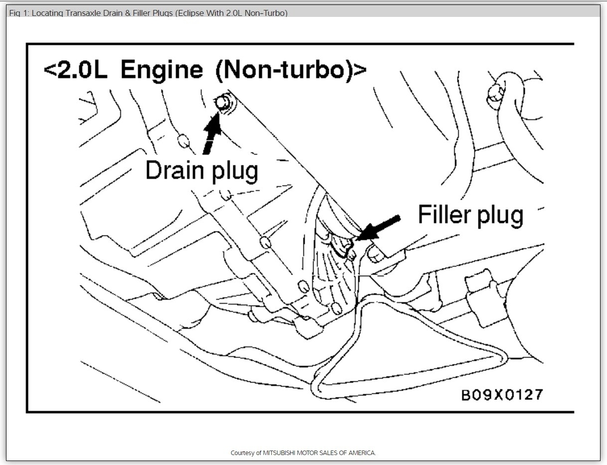

Transmission problem 4 cyl Front Wheel Drive Manual 160000 miles
Hello, I need to check and possibly fill my transmission fluid, however I can not locate the dip stick. If possible, can you include a picture or diagram as to where I can locate this in your response. Thanks!
Jan 29, 2008 at 4:54 AM
  • 55,421 POSTS
Manuals don't have dip sticks there should be a filler plug on the transmission but be sure you don't open the drain plug stick your finger in the filler plug and make sure the fluid level is even with the plug hole.
Here is some diagrams that will show you where the plug is located.
Please let me know if you need anything else to get the problem fixed.
Best, Ken
