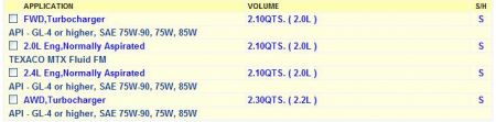

WHAT KIND OF OIL DO I MUST TO PUT ON THE TRASSMITION I MEAN 60,90 OR 140 THANKS
Dec 17, 2009 at 11:52 AM
MHPAUTOS
Experienced Mechanic
31,937 POSTS
Hi there, depending on model it will vary, so i have added the chart so you can pick yours out. mark (mhpautos)
