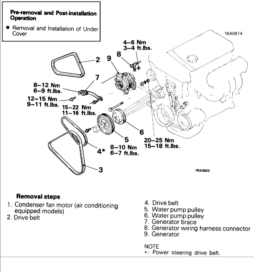

  • 55,797 POSTS
The battery light may or may not come one. With the alternator not charging it sounds like the alternator is not working. Can I ask what brand alternator you installed?
Here is a guide to check the alternator.
this will give you an idea of how to change it.
https://www.2carpros.com/articles/how-to-replace-an-alternator
And here is the way it is done on your car (Below)
Nov 15, 2017 at 2:42 AM (Merged)
DESIREVAMPYRE
  • 6 POSTS
We got everything working again, and come to find out that the whole time all it needed was to have the belt replaced. Even though it visually looked like it was moving as fast as it should be, the belt was slipping just enough to make the alternator undercharge.... but it's fixed now
thank you for all your help
