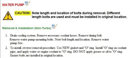

how can i r and r my water pump in a non-turbo eclipse

https://images.2carpros.com/forum/automotive_pictures/261618_Noname_1881.jpg
