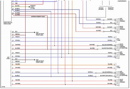

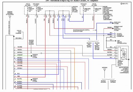

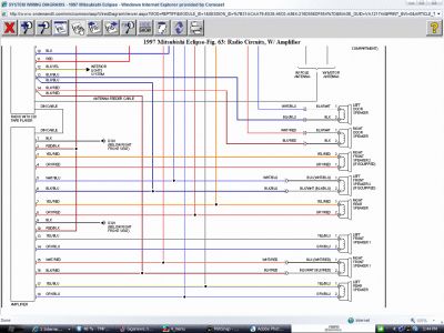

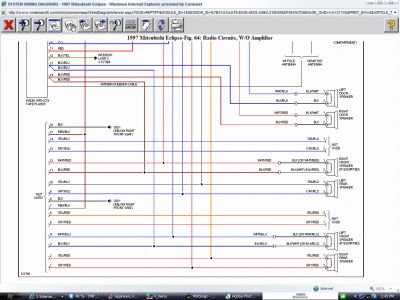

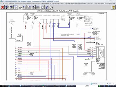

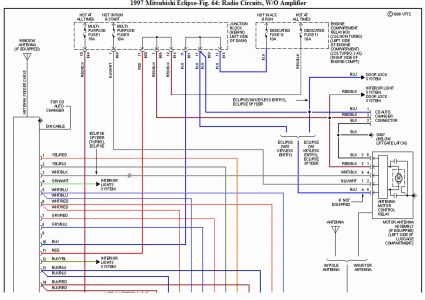

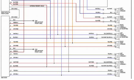

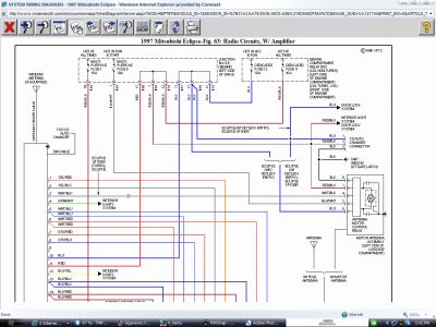

Ok so, i am trying to hook up a new cd player in my eclipse and the guy who had to car before me cut off the cd player adapter and wired every wire individually. So i got an adapter not knowing he cut the part that that connects to off. And the wires are color coated differently from my new cd player wires so i was wondering is there somewhere on the internet i can go to see what wires go to what speakers and battery and stuff....

Here you go the first two are w amp, the second two are without amp...
https://images.2carpros.com/forum/automotive_pictures/62217_Radiowamp1_1.jpg
https://images.2carpros.com/forum/automotive_pictures/62217_Radiowamp2_1.jpg
https://images.2carpros.com/forum/automotive_pictures/62217_Radiowoamp1_1.jpg
https://images.2carpros.com/forum/automotive_pictures/62217_Radiowoamp2_1.jpg

I will try these since email option is gone!
https://images.2carpros.com/forum/automotive_pictures/62217_Radiowamp1_2.jpg
https://images.2carpros.com/forum/automotive_pictures/62217_Radiowamp2_2.jpg
https://images.2carpros.com/forum/automotive_pictures/62217_Radiowoamp1_2.jpg
https://images.2carpros.com/forum/automotive_pictures/62217_Radiowoamp2_2.jpg
