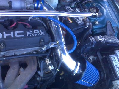

my car keeps jerkin and sounds like it backfires. i replaced the spark plugs with bosh platinums and the coil sensor. i herd u can clean the injectors and it would most likely solve the problem but i dont know where they are at can someone tell me where i can find them my car is 1996 Mitsubishi Eclipse RS [img:e998e2eee4]http://www.2carpros.com/forum/automotive_pictures/332176_IMG00083_1.jpg[/img:e998e2eee4]

HI there,
The injectors are fitted into the inlet manifold and are interconnected by the fuel rail, the best way to service the injectors is to have an on car carbon clean or similar service done, you don't clean them like you would a spark plug, if they are removed the can be individually flow & spray patten tested, this is a better way of doing it but more expensive as well.
