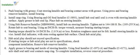

how do i replace the drivers side wheel barings?

https://images.2carpros.com/forum/automotive_pictures/261618_Noname_2847.jpg
https://images.2carpros.com/forum/automotive_pictures/261618_Noname2_933.jpg
