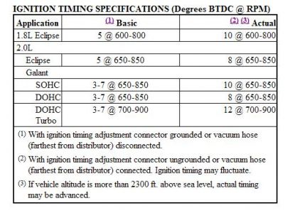

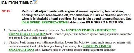

i need to find out how i ste the timming on my eclipse. i had someone replace the water pump and now i think that the timming is off. the motor just turns over

Hi there, first do a scan to see if there are any set fault codes. Timing as per tables. Mark (mhpautos)
