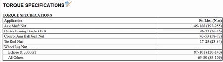

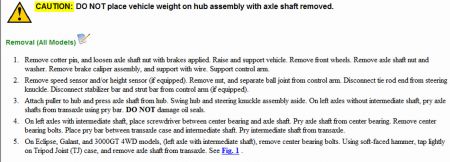

need to replace, what tools will I need and is there a diagram showing how to?

https://www.2carpros.com/forum/automotive_pictures/62217_CVAxle_1.jpg
https://www.2carpros.com/forum/automotive_pictures/62217_Specs_2.jpg
