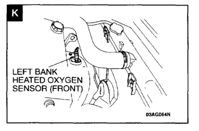

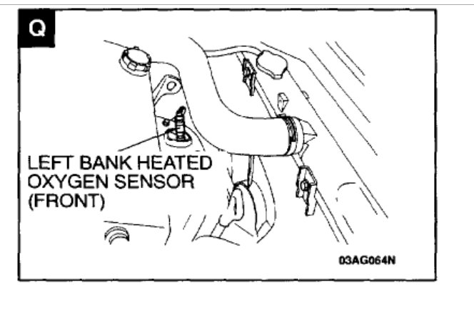

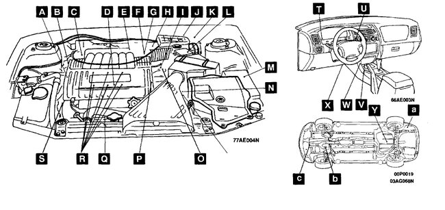

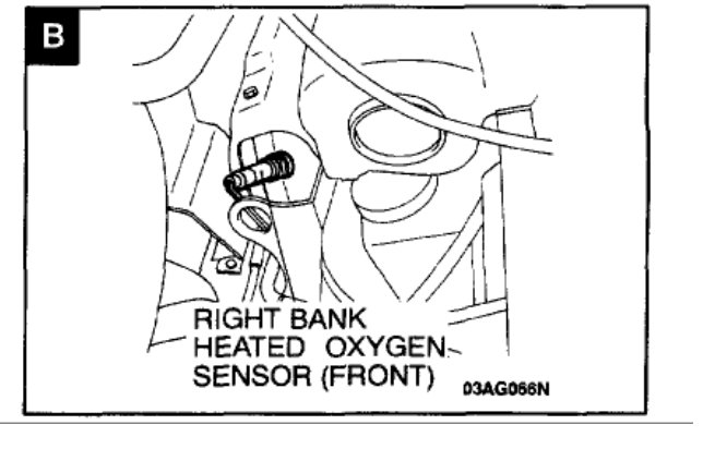

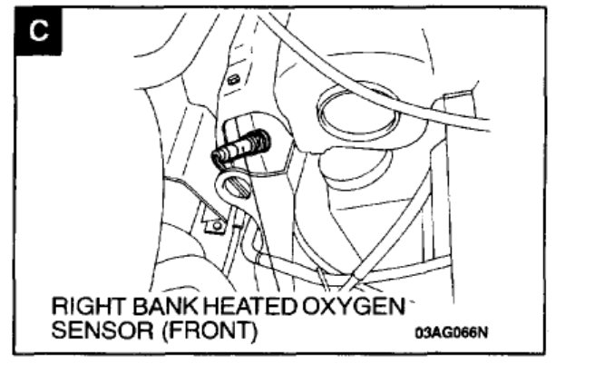

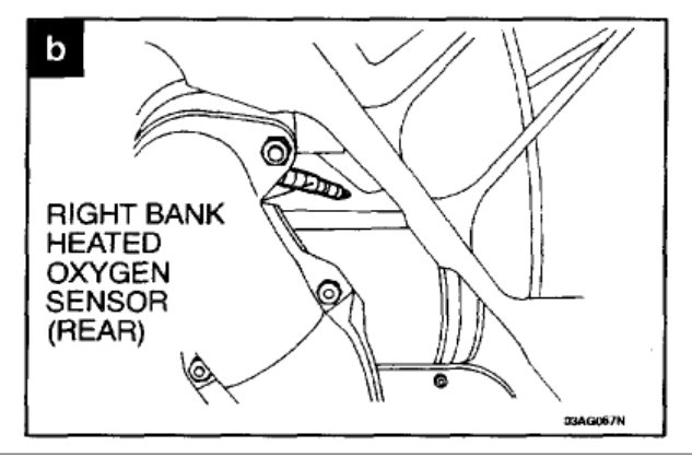

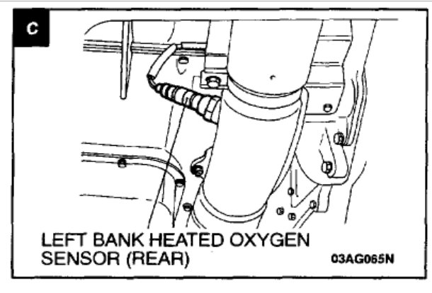

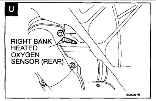

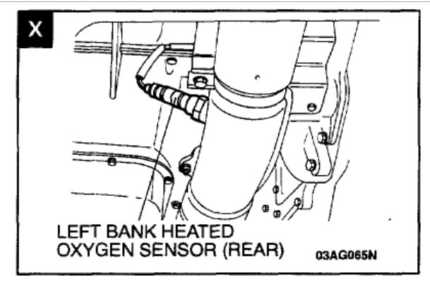

I need to know location of oxygen sensor sensor 1 bank 2 please help me!
Feb 8, 2008 at 3:49 PM
  • 55,423 POSTS
Here is a guide to help you see what you are in for when doing the job.
https://www.2carpros.com/articles/how-to-replace-an-oxygen-sensor
Here are the locations of each oxygen sensor both bank 1 and 2 upstream and downstream sensors.
