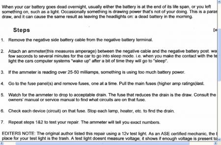

Sounds like a short eating up the battery or something is still on that's drawing current -battery drain test below.
https://images.2carpros.com/forum/automotive_pictures/12900_parastic_draw_1_215.jpg
