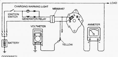

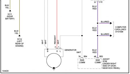

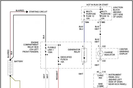

Could be, chec the "B" terminal to see if it's tight, be carefull, if you ground it accidentally, you could trip a fuse, or burn out a fuse link, remove negative battery cable first. Also check the Generator relay in the under hood fuse box. And the #8 Fuse in the same box on the driver's side inner fender.
https://images.2carpros.com/forum/automotive_pictures/62217_1_37.jpg
https://images.2carpros.com/forum/automotive_pictures/62217_2_35.jpg
https://images.2carpros.com/forum/automotive_pictures/62217_Gen_1.jpg

Hi Mike,
thanks very much for the suggestions and diagrams they have been extremely helpful and your very timely input is much appreciated !!!
I'll check the relay right away.

I hate to even ask after all your help but other than trial and error I'm not sure which relay in the box is the generator relay !!!
the marking on the box is poor to say the least amd there are a bunch of relays in there, i've googled for over an hour and could not find a description of the relays only the fuses..
BTW charging light was on again when i started the car at work this evening, i had my meter and I measured just over 12 volts idling to validate that it was not charging..
I stopped, started the car once more, then on the third attempt the charging light went off..
I'm off to get a relay tomorrow if i can find one at the local parts store .
Oct 12, 2009 at 10:06 PM
MERLIN2021
  • 17,250 POSTS
I'm not having any luck finding an ID chart either, but any Mits dealer can show you which one it is.
