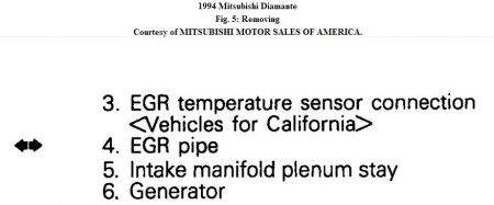

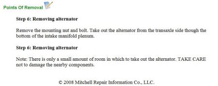

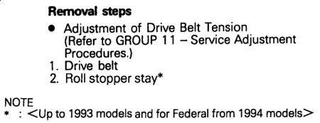

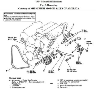

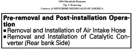

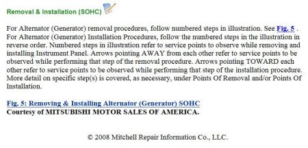

I have a 1994 mitsubishi dimante 6 cyl sohc and need to know how to get my alternator out. it's completely loose but I can't get it out.someone said to fish it out from the driver side alongside the firewall to the passenger side but that doesn't work. i've tried to take off my CV joints but that don't work either. I took my motor mounts off and jacked up the engine but that doesn't work. I've tried fishing it threw the top,bottom and nothing seems to work so SOMEBODY PLEASE HELP ME. I can't afford to take it to a shop.

Hi mikeysoprano1, Here are the removal and installation procedures.
https://images.2carpros.com/forum/automotive_pictures/192750_AlternatorRemoval94DiamanteSOHC01_1.jpg
https://images.2carpros.com/forum/automotive_pictures/192750_AlternatorRemoval94DiamanteSOHC02_1.jpg
https://images.2carpros.com/forum/automotive_pictures/192750_AlternatorRemoval94DiamanteSOHC02a_1.jpg
https://images.2carpros.com/forum/automotive_pictures/192750_AlternatorRemoval94DiamanteSOHC02b_1.jpg
https://images.2carpros.com/forum/automotive_pictures/192750_AlternatorRemoval94DiamanteSOHC02c_1.jpg
https://images.2carpros.com/forum/automotive_pictures/192750_AlternatorRemoval94DiamanteSOHC03_1.jpg

Alternators are on front of engine. At rear end, next to transmission is the starter motor.
Is the diagram of the alternator correct?
