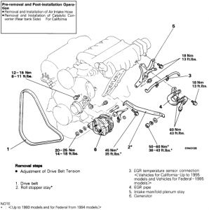

hOW DO YOU REMOVE AN ALTERNATOR FROM A 1994 MITSUBISHI DIAMANTE SOHC 3.0L
Tuesday, January 12th, 2010 AT 7:40 PM
  • 75,992 POSTS
Generator - Removal And Installation
https://www.2carpros.com/forum/automotive_pictures/12900_alternator1_2.jpg
Pre-Removal
*Air Intake Hose
*Catalytic Converter
REMOVE
*Adjustment of drive belt tension
1.Drive belt
2.Roll Stopper Stay
3.EGR Temperature Sensor Connection
4.EGR Pipe
5.Intake Manifold Plenum Stay
6.Generator
INSTALL
1.Generator
2.Intake Manifold Plenum Stay
3.EGR Pipe
4.EGR Temperature Sensor Connection
5.Roll Stopper Stay
6.Drive belt
Post-Installation
*Air Intake Hose
