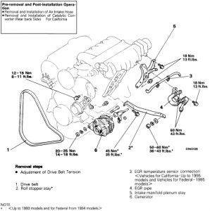

hOW DO YOU REMOVE AN ALTERNATOR FROM A 1994 MITSUBISHI DIAMANTE SOHC 3.0L

Generator - Removal And Installation
https://images.2carpros.com/forum/automotive_pictures/12900_alternator1_2.jpg
Pre-Removal *Air Intake Hose *Catalytic Converter REMOVE *Adjustment of drive belt tension 1.Drive belt 2.Roll Stopper Stay 3.EGR Temperature Sensor Connection 4.EGR Pipe 5.Intake Manifold Plenum Stay 6.Generator INSTALL 1.Generator 2.Intake Manifold Plenum Stay 3.EGR Pipe 4.EGR Temperature Sensor Connection 5.Roll Stopper Stay 6.Drive belt *Adjustment of drive belt tension Post-Installation *Air Intake Hose *Catalytic Converter
