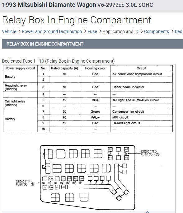

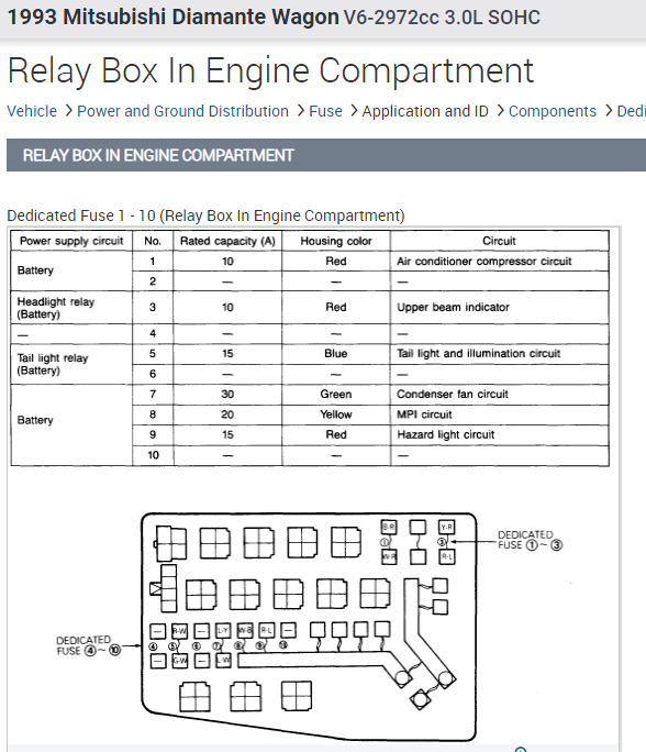

Help! I bought a Station wagon cheap because it has a few electrical issues. Any hints as to what might be going on?? I need to check the fuses.

Finding electrical issues can sometimes be tricky.
It will require you to cross check all the wires and fuses/relays.
Can you tell us the issues that you are having? We might be able to narrow down the search.

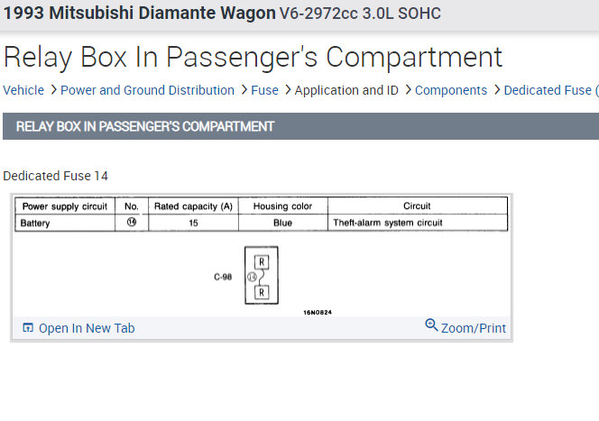

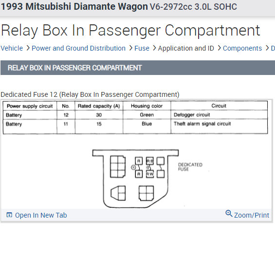

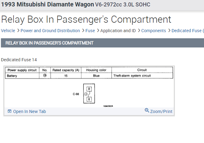

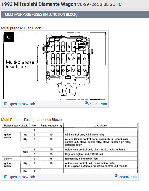

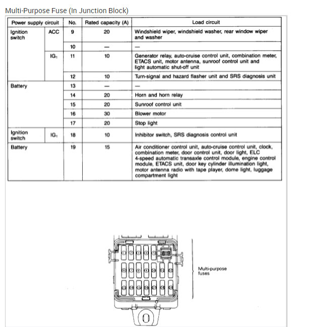

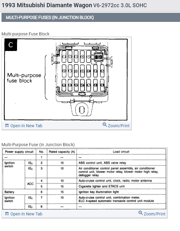

There is a fuse block under the hood on the driver side and other one under the driver side dash.
Here are some helpful articles:
I have attached the fuse diagrams for your Diamante.
