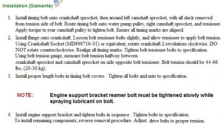

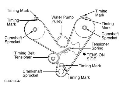

i need to know the setting to set my timing belt my car thanks

https://images.2carpros.com/forum/automotive_pictures/261618_Noname_1694.jpg
https://images.2carpros.com/forum/automotive_pictures/261618_Graphic_343.jpg
