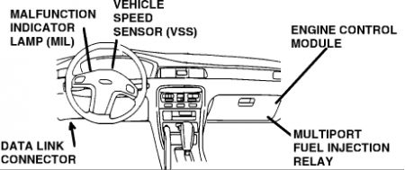

Can't seem to locate in chilton's manual. Please tell us where to locate the fuel pump relay. It sounds like the pump is still running after car is shut off, would that be the fuel pump relay?

Hi destinysexton,Welcome to 2carpros and TY for the donation. You are looking for the Multiport fuel injection relay which powers the fuel pump relay-See diagram below: Passenger Compartment Components
https://images.2carpros.com/forum/automotive_pictures/12900_fpr_16.jpg
Multiport Fuel Injection Relay, Located Behind Glove Box
https://images.2carpros.com/forum/automotive_pictures/12900_fpr1_2.gif
The multiport fuel injection relay, is located in the right side of the dash, behind the glove box. https://www.2carpros.com/kpages/auto_repair_manuals_alldata.htm
