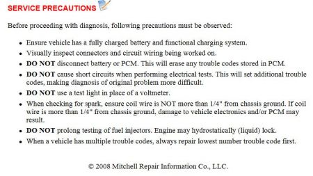

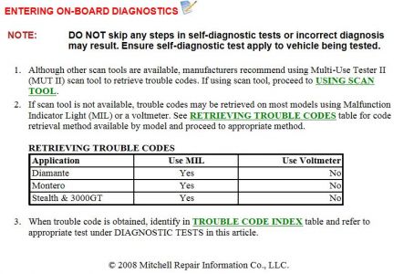

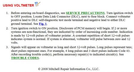

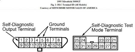

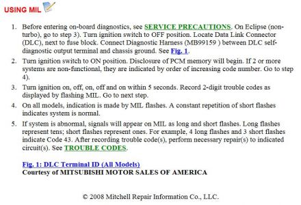

Hi g89nguyen, Thank you for the donation. Is the Check Engine Light showing? For Mitsubishi vehicles, sometimes the CEL does not show but codes are stored by the PCM. This being a pre OBD II engine, your local parts store, which provides free scanning, might not be able to help you as their scanners might not be compliant. If you are technically inclined, you can retrieve the codes yourself and with the codes, it would help in diagnosing the problem. Let me know what you find and we can proceed from there.

If it is a fault with the IAC, it would normally produce a stored code. Did you do the test outlined above?
If no codes are stored, cleaning the IAC, throttle body and readjusting the idling speed should solve the problem.
