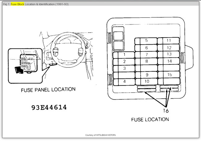

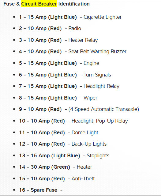

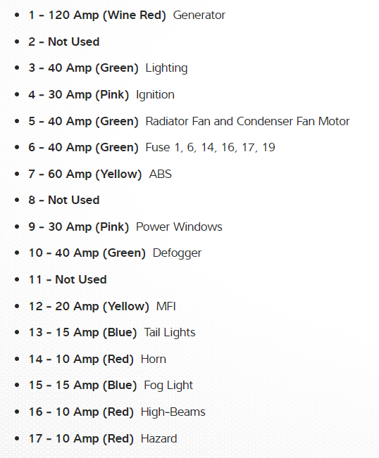

Picture if possible also i need to know what each fuse is for and where they are located pic .
Wont turn over ran out of gas a couple days before thought sit had something to with the fuel pump also maybe if a fuse is broke or missing or need a picture if you could possible appreciate it very much
May 26, 2020 at 4:10 AM (Merged)
  • 55,673 POSTS

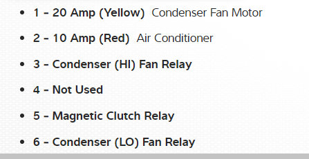

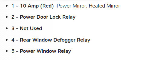

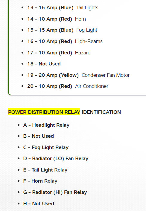

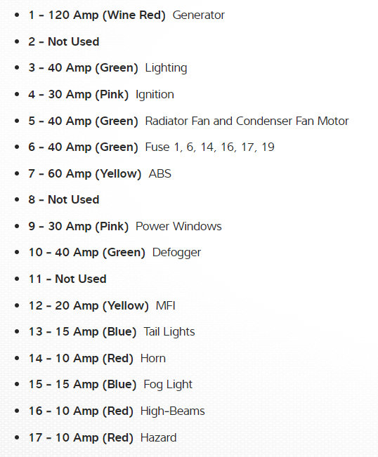

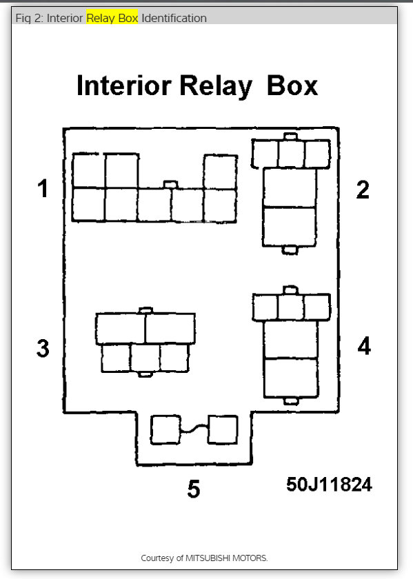

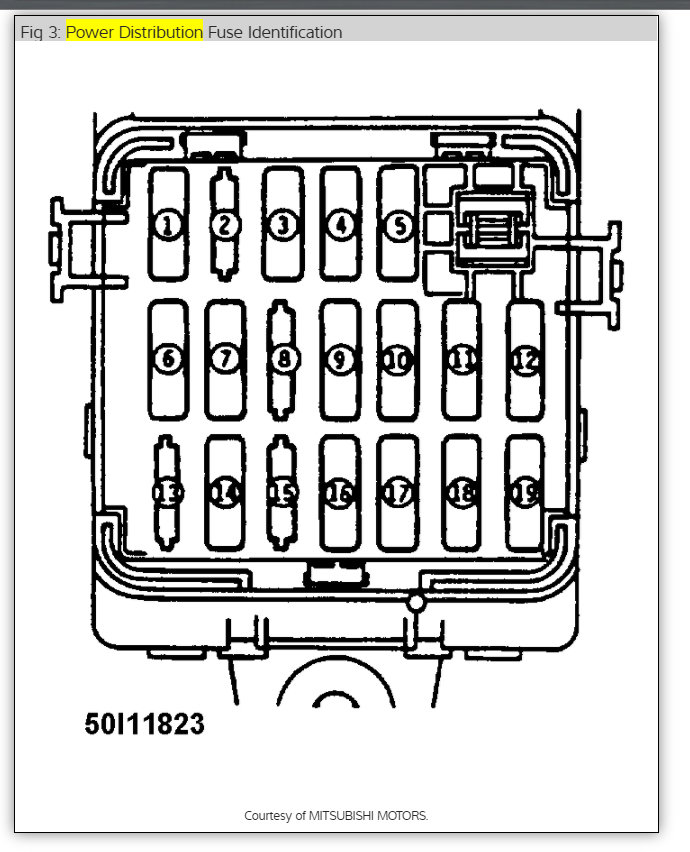

The fuel pump receives voltage supply from Multi-Point Injection (MPI) control relay. Here is a guide to help you check out the relay and fuses.
and
Check out the diagram (below)

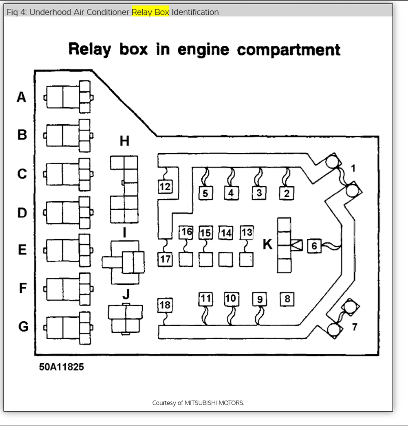

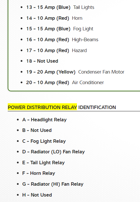

can not find fuel pump relay or shut off on my car witch is not leting new fuel pump run
MADCOWMOTORS
  • 6 POSTS

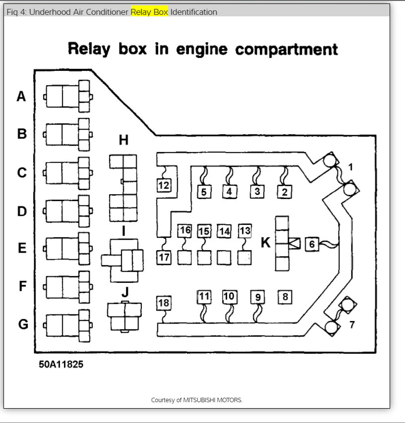

Likely an under the hood fuse/relay box. Should be labelled. Check all your other fuses too. Good luck

Where is the fuel pump relay switch located on a 1993 Mitsubishi 3000 GT base model non turbo I need 1 bad and I need help please help
  • 75,988 POSTS
PFI Control Relay Behind right front of center console-sorry no pic location
