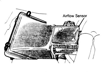

Hi Check Air Flow Meter
https://images.2carpros.com/forum/automotive_pictures/198357_Graphic_359.jpg
See if contaminated also air box has tight seal. Do you have an OHM meter? Let me know Thanks for donate
