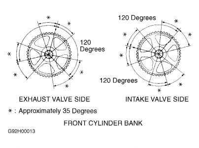

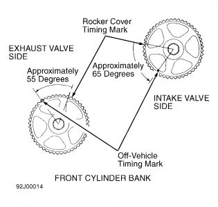

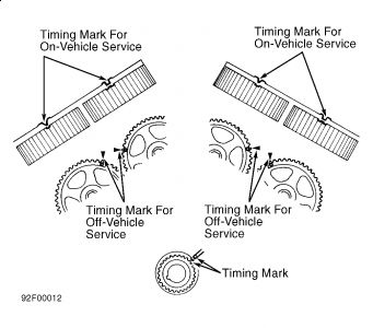

1991 MITSUBISHI 3000GT
Engine Mechanical problem
1991 Mitsubishi 3000GT 6 cyl Front Wheel Drive Manual
set the timing
Thursday, July 16th, 2009 AT 8:30 PM
BLUELIGHTNIN6
MECHANIC
16,542 POSTS
Thursday, July 16th, 2009 AT 10:11 PM
