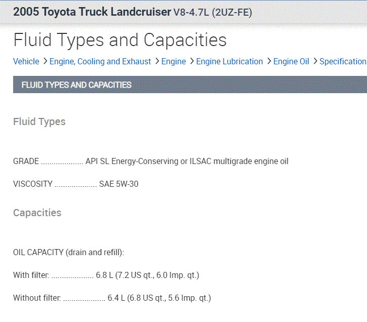

Hello, I completed my first oil change on my car about three weeks ago. At first my car seemed to be driving normally. However, recently, when I turned on my car, a lot of smoke came out the back exhaust pipe. Then, when I tried to drive on the highway, my car had trouble accelerating even when I was stepping on the gas hard. It took about ten seconds for the car to go up to 30 mph. I took it to the shop, but I was just wondering if these symptoms sound like the result of changing the oil incorrectly ? Thanks !

Since it didn't happen right away, I don't suspect the oil was overfilled. However, it's possible. Also, can you tell me what color the smoke was? For example, was it blue, black/gray, or white? Were there any strange odors from it? Were there any sounds such as ticking or knocking from the engine?
The color of the smoke can tell us a lot. For example, if the oil was blue in color, that is an indication of motor oil being burned.
Black/gray smoke oftentimes indicates a rich fuel mixture.
White smoke usually indicates that coolant is getting into the combustion chamber due to a faulty head gasket.
Since there are different possibilities, the first thing I would recommend checking is the oil level and condition. Make sure it isn't overfilled and is clean.
Next, confirm the coolant level isn't getting low, which could indicate a head gasket issue.
Last, here is a link that explains how to check for a bad head gasket. Take a look through it and inspect the items indicated.

If you look at the picture below, it shows the oil type and capacity required for this vehicle.
See pic below.
