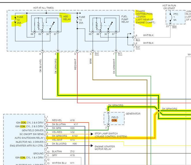

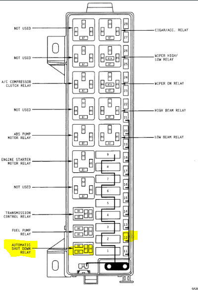

While driving the engine stopped and I towed it to my home. i had to change Camshaft and crank shaft sensor, but it still does not work. I test circuit 44, 43, 32, 33 they are okay but when jump start, voltage signal both camshaft and crank shaft at 5 volts do not change. test power to ignition coil, no power when crank the engine. Please someone help, which part or circuit number came from coil to before came to ECM, provide the power when turn the key or crank the engine. I have change new ECM still same. I am retired and trying to save money and my wife is very sick. Thank you
Sep 16, 2022 at 4:15 PM
  • 110,194 POSTS
Power to the coils is from the automatic shutdown relay (ASD). The ASD is powered by fuse 12 in the under-hood fuse box. See pic 1
Pic 2 shows the relay and fuse location.
That is where I would start. If the fuse is good and has power, switch the relay with a different one having the same part number to see if that changes things.
If there isn't one, here is a link that explains how to test one:

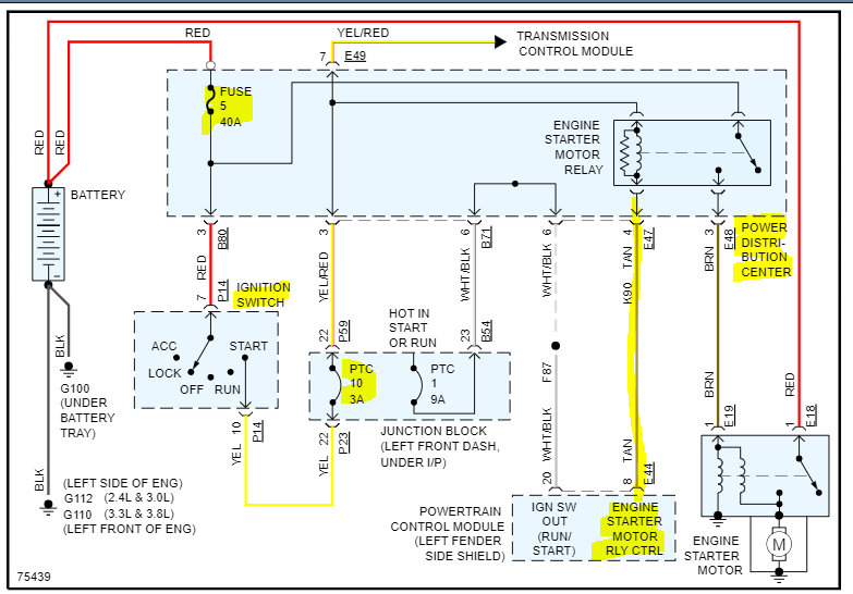

If the cam and crankshaft sensors are new, that is not the likely cause. I may have already asked, but do you have a live data scan tool? If you do, check to see if there is an RPM signal when cranking.

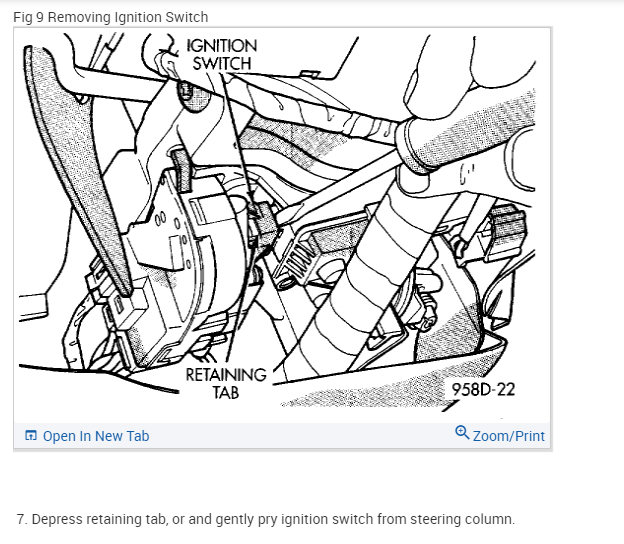

Now, if I understand correctly, the key no longer engages the starter. I'm starting to question if the ignition switch is the problem.

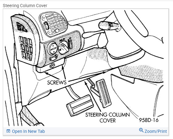

Take a look at the starting system circuits schematic. Check the fuses I highlighted and let me know what you find.
See pic below.
Sep 17, 2022 at 10:30 PM
MUIYEN
  • 8 POSTS

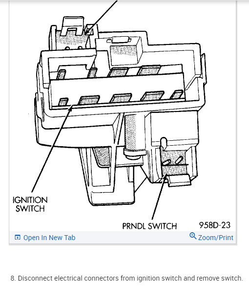

Hi Joe, how are you? Today I have check the diagram you gave to me, from the ignition switch to the relay, PTC circuit okay, but from the key is missing the power to relay, the switch ignition is not working. I have ordered the new switch already. Now mean time I have waiting for new coming, then I can see next. I will let you know.
Thank you
Have a good Sunday evening.
Sep 18, 2022 at 7:50 PM

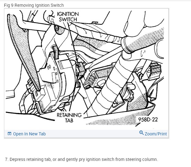

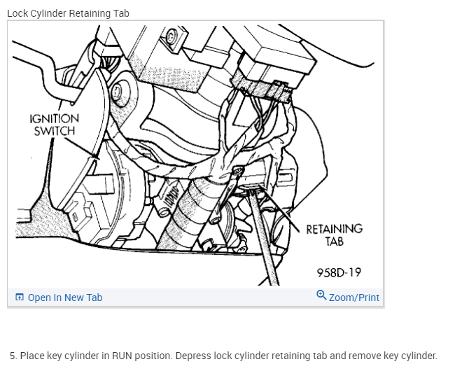

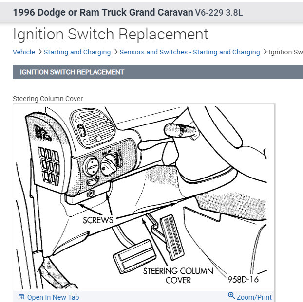

  • 110,194 POSTS

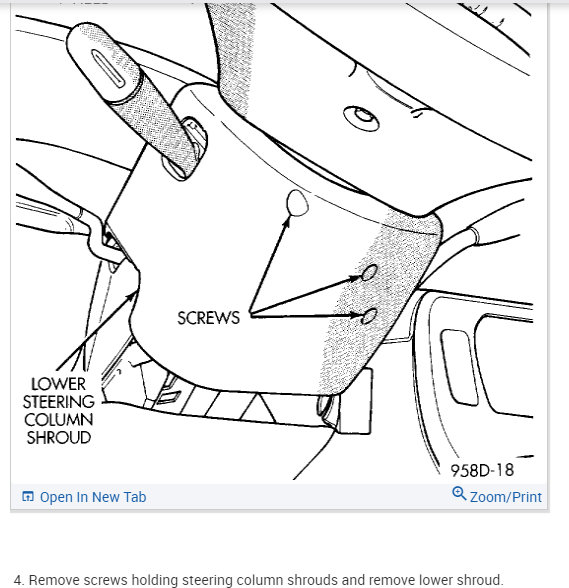

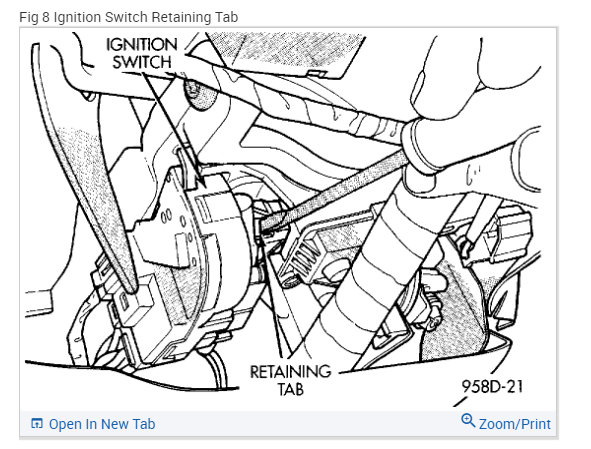

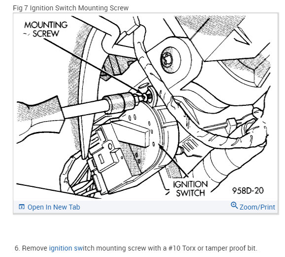

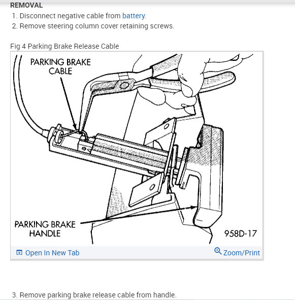

It sounds like you found the issue. I don't know if you need them, but I included the directions below for replacing the switch. If you want to confirm the switch is the issue, test for power out from the switch itself to the relay.
Let me know if you have questions or if I can help.
Sep 19, 2022 at 7:01 PM
MUIYEN
  • 8 POSTS
Hi Joe, the last picture is the ignition switch. You sent to me that is the correct one, when I turn the key, relay not work, test the power, nothing appears to yellow wire to PTC number 10 3A, that why I have to order the new switch. I will let you know next.

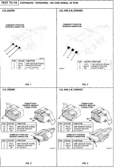

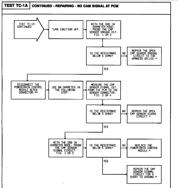

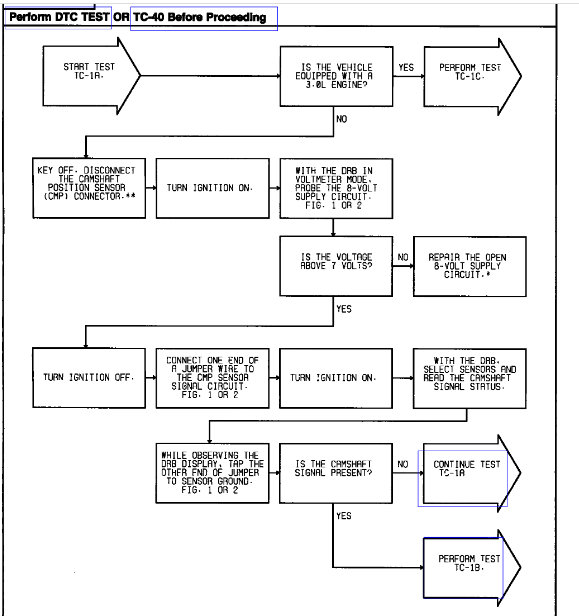

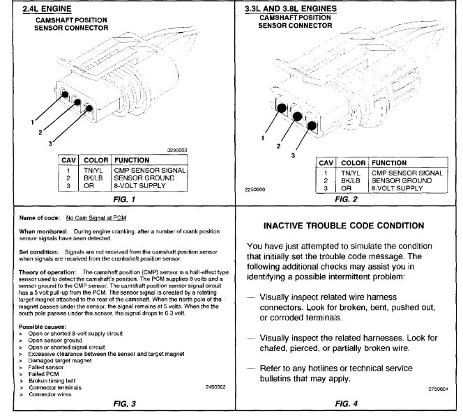

Hi Joe, how are you? Today I have hooked up the new Ignition switch, test engine crank okay, now, fuel pump is working, just engine no spark, no power appear at B+ ignition coil pack. I use scan come up error code P0340.
Joe, I am really very confused what is wrong, where is missing the power, I have tried to look in many diagrams, but really don't know where to check?
Please help, thank you very much. Have a nice day.
Sep 22, 2022 at 3:16 PM
  • 110,194 POSTS

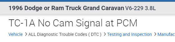

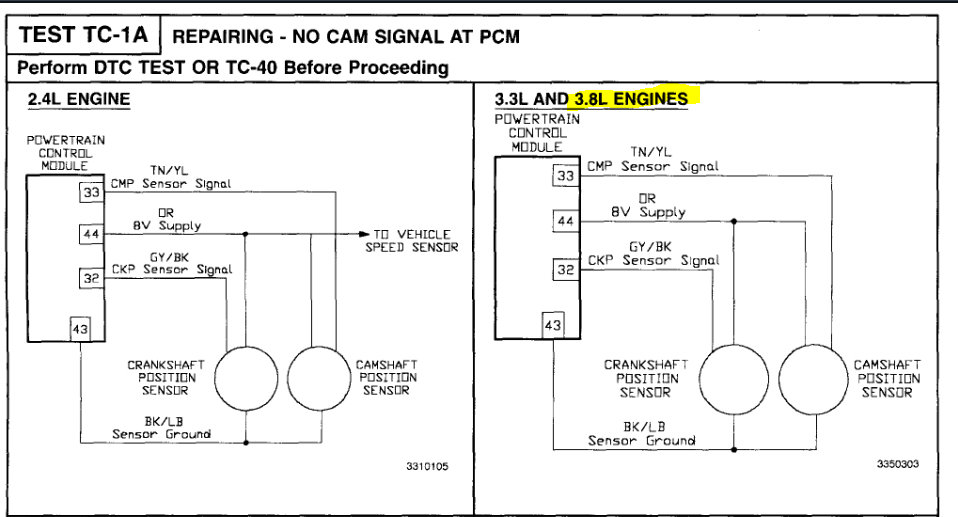

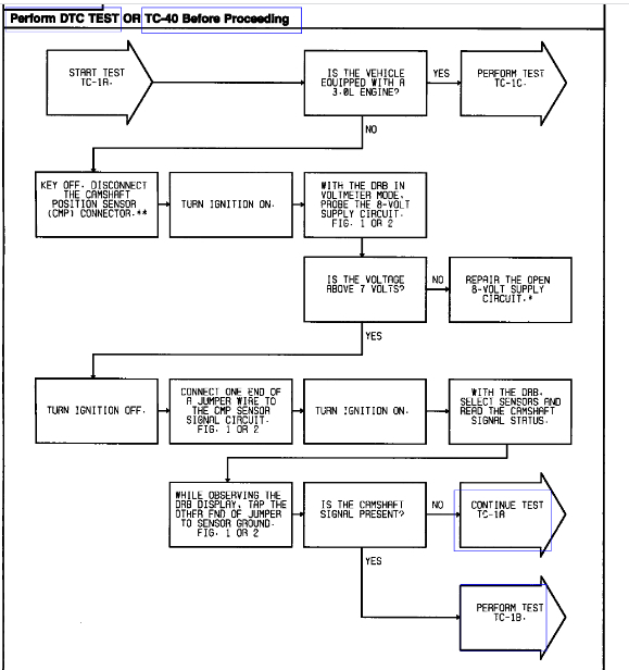

If the camshaft position sensor is bad, it can prevent spark to the plugs. Have you done anything with the sensor?
I attached the diagnostics below related to the code. Take a look through them and let me know if you are comfortable performing them.
see pics below.
Sep 22, 2022 at 7:56 PM

Hi Joe, today I have check the picture you gave to me, camshaft and crank shaft position sensor I had replaced already, look at when key on at camshaft position sensor, It have more than 8 volts and signal sensor It got more than 5 volts, than the final, I check from camshaft sensor signal wire by ohm meter to PCM 33 It read 4ohms ,with procedure say, is resistance below 5 ohms need repair the CMP sensor signal circuit for short or ground.
Mr. Joe, what do you think, do I have to replace the wire, what size wire do I need to replace?
Have a good evening.
Sep 23, 2022 at 6:51 PM
  • 110,194 POSTS
Are you able to trace the wire rather than replace it? Also, have you checked the connectors for corrosion or anything that can be causing an issue?
As far as replacing it, the connectors at both ends can be a bit difficult to deal with. If I had it, I would be trying to locate the short to ground. Make sure the signal wire hasn't been pinched or pulled causing a short,
Let me know what you find.
