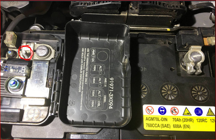

Hello. I am not very handy at all and neither is my wife. She was trying to replace the dead battery of her 2014 Hyundai Elantra SE and was trying to take off the terminals and dropped at least one piece of hardware (she thinks that it may have been a wing nut and then something else) into the abyss. She think it is on the right side (standing from the front of the car looking into the hood) and I tried to use some magnetic pickup tools but could not find it.
Now I am trying to figure out how to properly secure the terminals because I do not know what hardware she is missing.

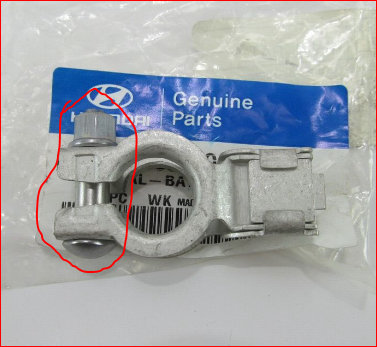

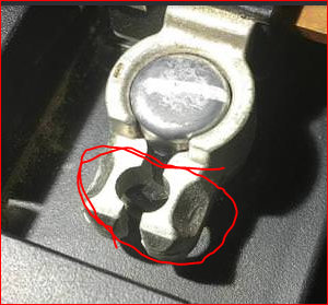

The battery terminals that are on the vehicle are original. The only place you might be able to get the parts is from the dealer. And yes, there are two nuts missing and the cross tensioner is missing on the neg terminal. If you look at the terminal, there are two recessed areas on the sides of the terminal. The cross tensionier that is missing causes the terminal to close as it is tightened.
I have done some research for you. If you contact a dealer, ask them if they can get part numbers:
91982C7010 this is the positive terminal with a retail cost of around 25.00
37180-3X001 this is the negative battery cable. retail is around 70.00
The OEM parts are expensive and I question if the positive terminal itself will be available. Believe it or not, the positive cable is over $200.00. (part 91850-3Y110)
I would find the parts she dropped. Check along the lower control arm, the frame. It has to be there somewhere. By the way, the magnet is a great idea.

I have attached two additional pictures as well as your two as to what you are missing. On the positive clamp a nut is missing (circled in red). On the negative clamp the nut and bolt the tightens the connection is missing. Your local auto parts stores should have the replacements. A Hyundai dealership definitely will but will be a little more expensive. Hope this helps and feel free to ask any other questions if needed. Thanks for using 2CarPros.
