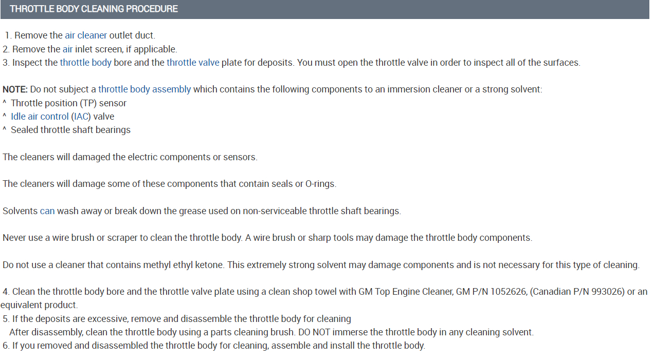

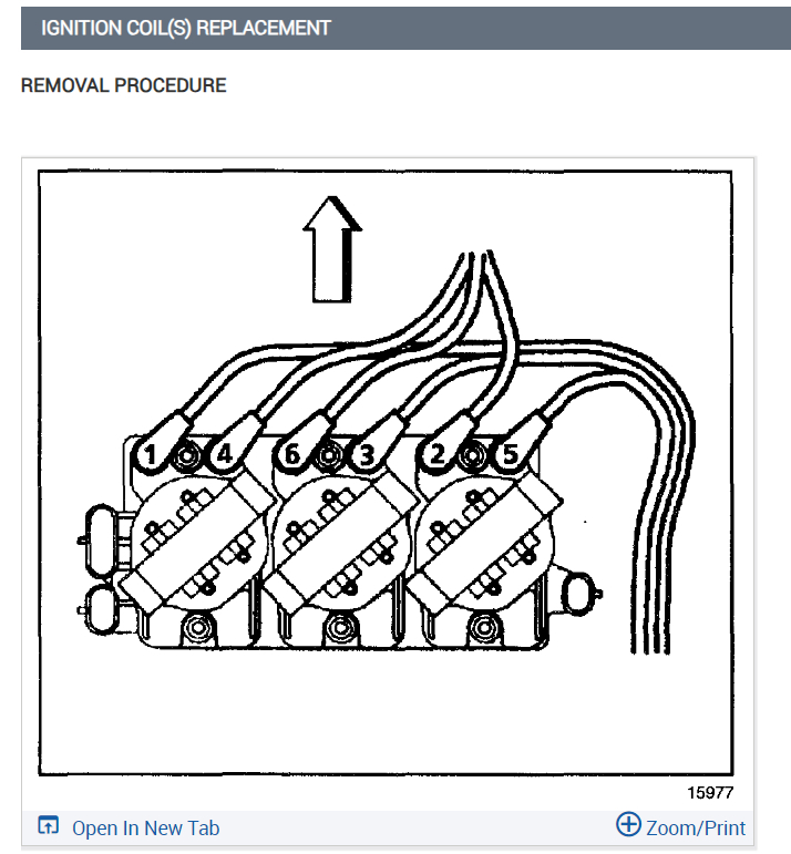

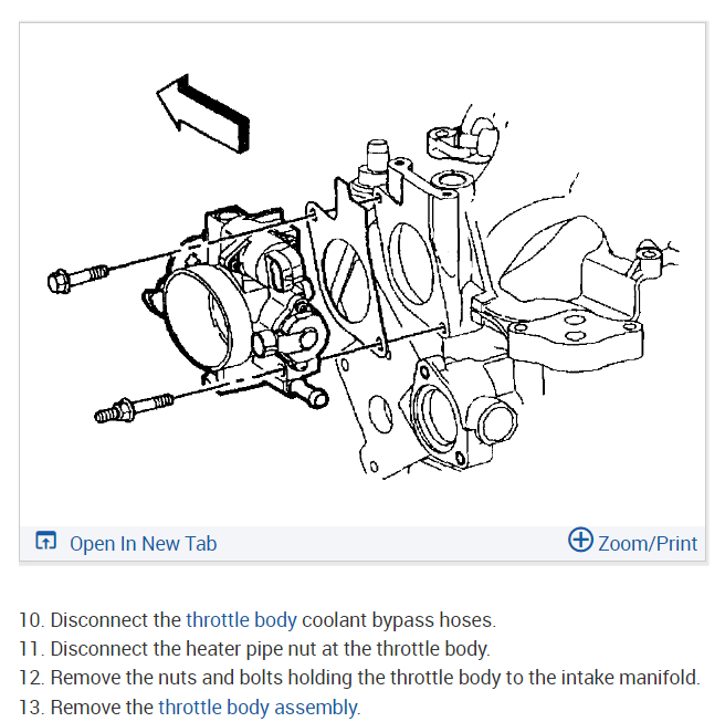

For the last couple weeks when I start up and take off cold, my car misses for a few then stops. there's no check engine light on so I don't know what it could be, do you?
Mar 6, 2024 at 8:09 PM
  • 55,447 POSTS

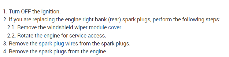

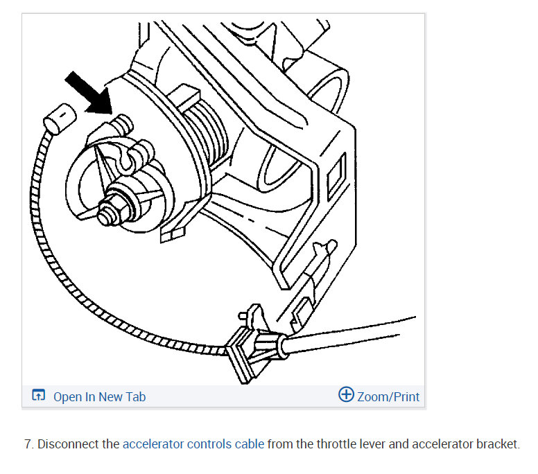

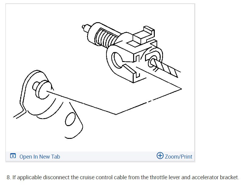

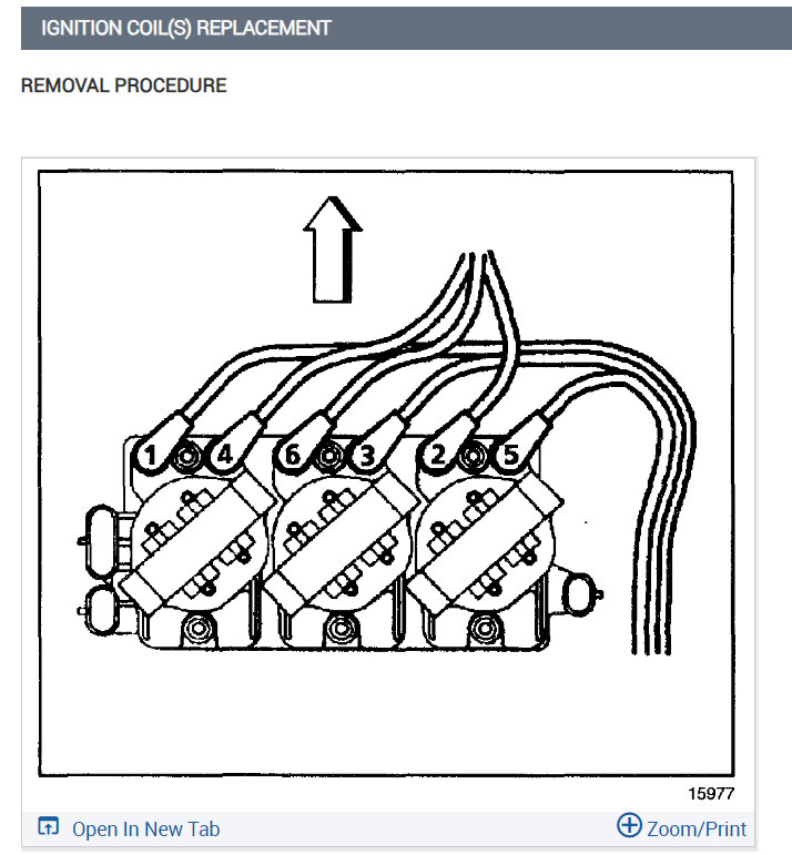

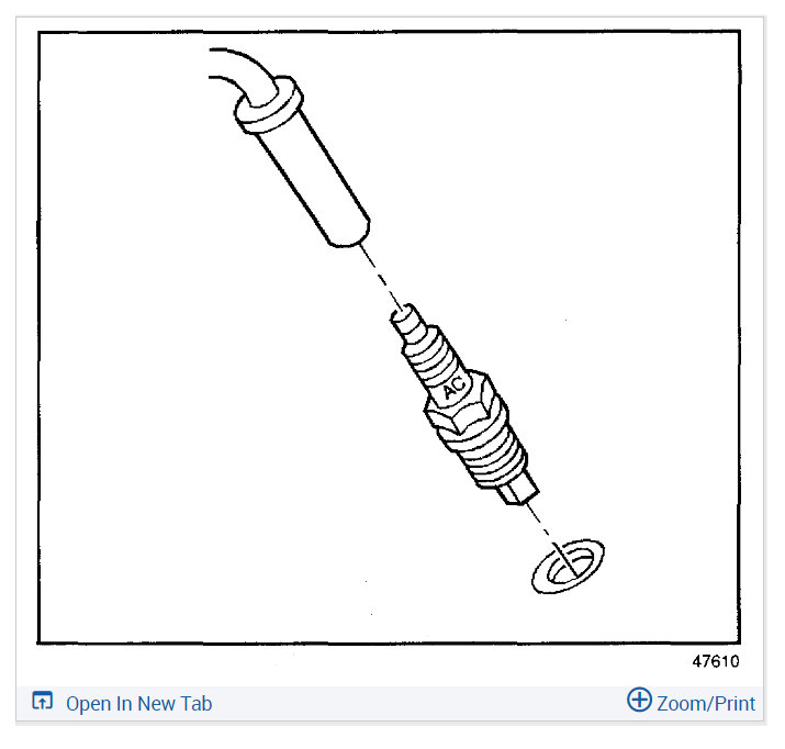

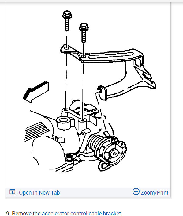

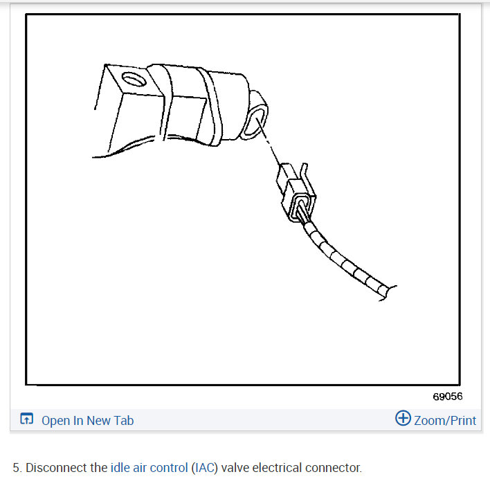

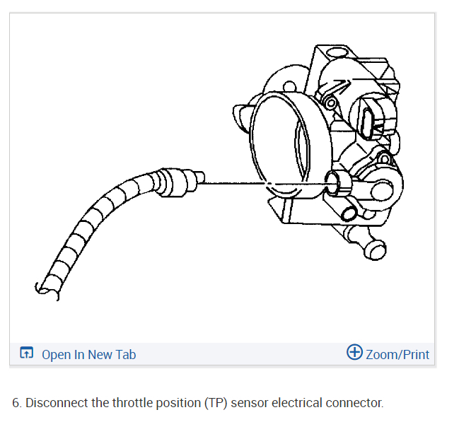

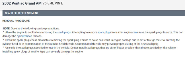

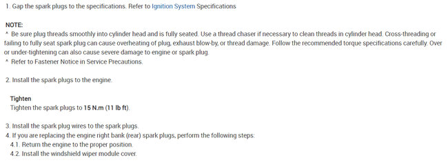

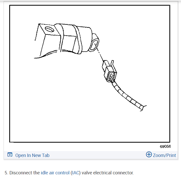

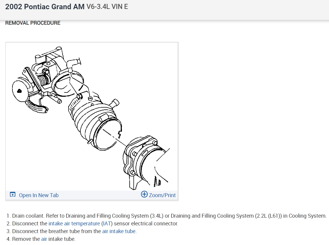

I would start with a tune up, new spark plugs and wires, also service the throttle bore and IAC. I have also seen the coil pack go bad, but I would start with the plugs and wires. This guide can help walk you through the service with instructions in the images below for your car:
https://www.2carpros.com/articles/how-to-tune-up-a-car-engine
and
Spark Plug .................... AC Type 41-940
1.52 mm (0.060 in)

Isn't ac 41-101 spark plug the right one to use?
Mar 7, 2024 at 12:23 PM
  • 55,447 POSTS
The book is calling for a
This plug might have been superseded.
