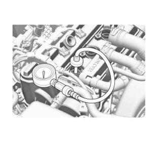

Idle comes from missing issue. I have check spark plug, ignition coils, injectors, intake manifold gaskets, cylinder compression checked there is no problem in this parts. And check vacuum and electrical parts no problem. engine vibration hard started the car. what is problem in this car? And car running 2,300 km.

I have all operations check but my dought intake and exhaust valve.

At this mileage, I doubt the valves are a concern, but one never knows. If you suspect there is an issue with the intake or exhaust valves, I recommend performing a compression test to see if everything is within spec. But again, you really should have the dealer doing this. If something happens and you worked on the vehicle, they could deny warranty repairs. Here is a link that shows in general how to check compression:
Here are the directions specific to your vehicle for testing. The attached picture correlates with these directions.
_______________________________________
Engine Compression Inspection
Inspection
NOTE: After this inspection, you must reset the PCM (CLICK HERE). Otherwise, the PCM will continue to stop the injectors from operating.
1. Engine - Warm Up
1.
Start the engine. Hold the engine speed at 3,000 rpm with no load (in P or N) until the cooling fan comes on, then let it idle.
2. HDS - Connect (CLICK HERE)
3. All INJECTORS STOP - Select
1.
Select ALL INJECTORS STOP in the PGM-FI INSPECTION menu with the HDS.
4. Ignition Coil and Spark Plug - Remove (CLICK HERE)
5. Engine Compression - Inspect
See Picture 1
1.
Attach a compression gauge to the spark plug hole.
2.
Step on the accelerator pedal to open the throttle fully, then crank the engine with the starter motor, and measure the compression.
Compression Pressure:
Above 980 kPa (9.99 kgf/cm2, 142.1 psi)
3.
Measure the compression on the remaining cylinders.
Maximum Variation:
Within 200 kPa (2.04 kgf/cm2, 29.0 psi)
4.
If the compression is not within specifications, perform a cylinder leak down test to determine the problem area. Then check the following items, and remeasure the compression:
Incorrect valve clearance (CLICK HERE)
Confirmation of camshaft timing (CLICK HERE)
Damaged or worn cam lobes (CLICK HERE)
Damaged or worn valves and seats
Damaged cylinder head gasket
Damaged or worn piston rings (CLICK HERE)
Damaged or worn piston and cylinder bore (CLICK HERE)
5.
Remove the compression gauge from the spark plug hole.
6. Ignition Coil and Spark Plug - Install (CLICK HERE)
7. All INJECTORS STOP - Cancel
1.
Select PCM reset in the PGM-FI Mode menu to cancel ALL INJECTORS STOP with the HDS (CLICK HERE).
