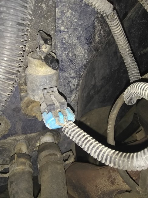

There is a module in the engine bay mounted by the firewall that has two hose inlets that have nothing connected to them. I need help figuring out what this is and what it is suppose to lead to. I have a picture of it, but cannot find any diagrams that show it.

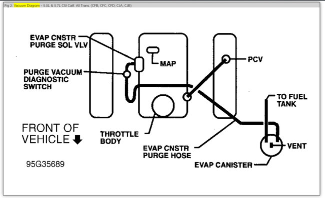

That is the control valve for the EVAP system. Here is a vacuum hose diagrams (below) that will help you get it fixed. Check out the diagrams (Below). Please let us know if you need anything else to get the problem fixed.
