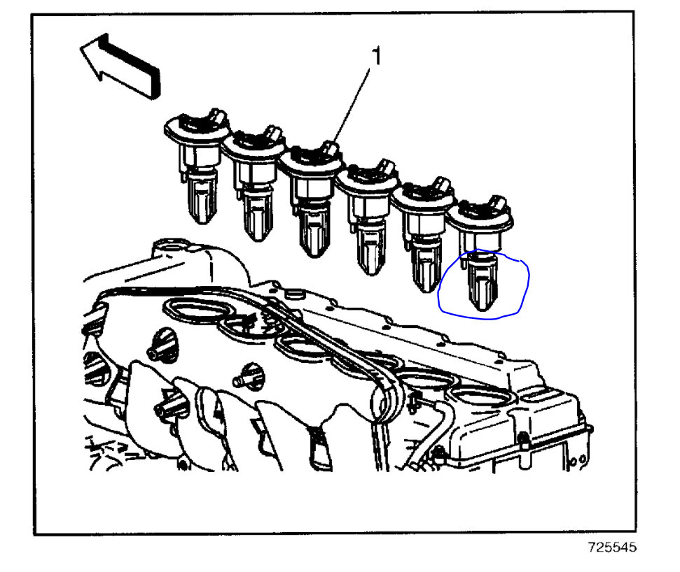

Intermittent misfire while driving
2002 GMC ENVOY
125,000 MILES • 4.2L • 6 CYL • 4WD • AUTOMATIC
MHUBSHMAN
At stops it wants to stall. Misses bad on and off while driving. I changed cam sensor, crank sensor, new plugs, cleaned throttle body. Still runs the same.

Good evening,
Did you change the boots on the coil when you replaced the plugs? They are very common for failing.
I would also do a compression test to be sure the internals are good in the engine.
What are the codes that are set?

Showing no codes.
May 17, 2021 at 10:35 AM
Okay, I would do the other checks I suggested.
