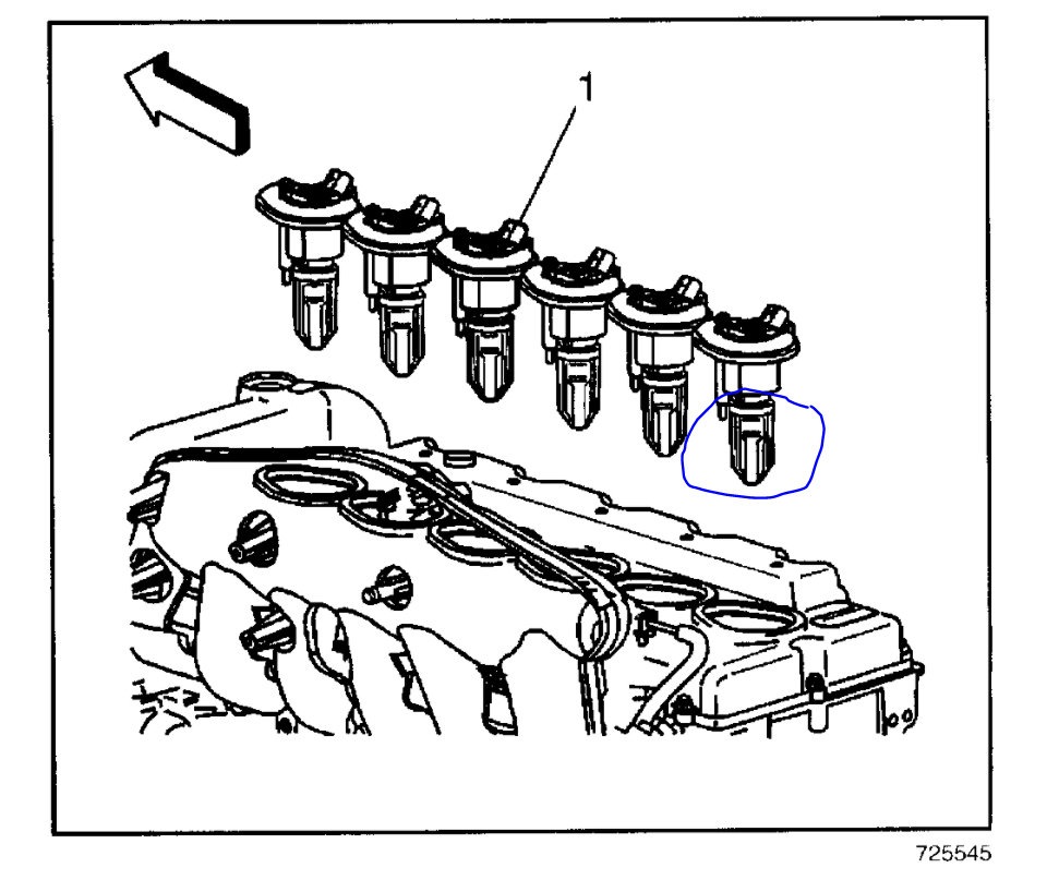

At stops it wants to stall. Misses bad on and off while driving. I changed cam sensor, crank sensor, new plugs, cleaned throttle body. Still runs the same.

Did you change the boots on the coil when you replaced the plugs? They are very common for failing.
I would also do a compression test to be sure the internals are good in the engine.
What are the codes that are set?

Showing no codes.
May 17, 2021 at 5:35 PM
Okay, I would do the other checks I suggested.
