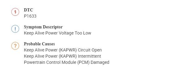

When first crank car up it idles too high. Going down road pushing the accelerator it bogs down and pops and don't won't to go but let off the accelerator it goes on its own. Check engine light and airbag light is on. Can't see the mileage screen because it does not work. It is missing very badly. Code p1633 on My obd2 is popping up.My husband is a mechanic and he has replaced a bunch of stuff and we have gone over the entire car trying to figure out this issue. Please help.

Is the P1633 the only code in the system? It seems unlikely that if the engine light is on and runs poorly that it will only have a keep alive memory code.
This light will turn on due to the code but unless the PCM is damaged causing the light and the running issue, we need a little more to go on.
So let's start with checking fuel pressure while running. Then check for a vacuum leak.
Here are some guides that will help with this. Let me know what you find and we can go from there. Thanks

Is 1633 the only code?
This code is for the keep alive memory for the PCM. Make sure he checks all the fuses for power on both sides. This is not a visual test, it is a power test.
