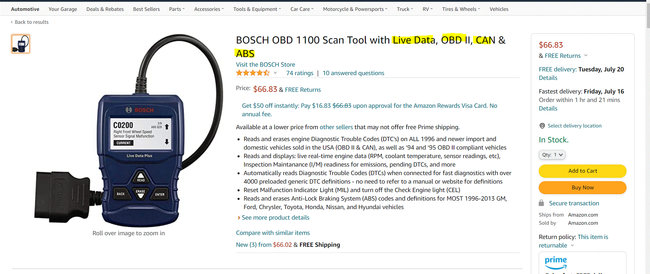

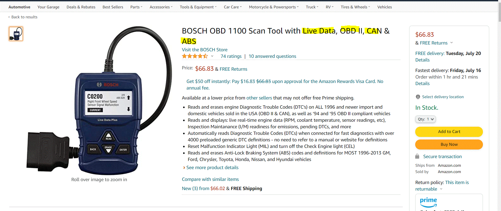

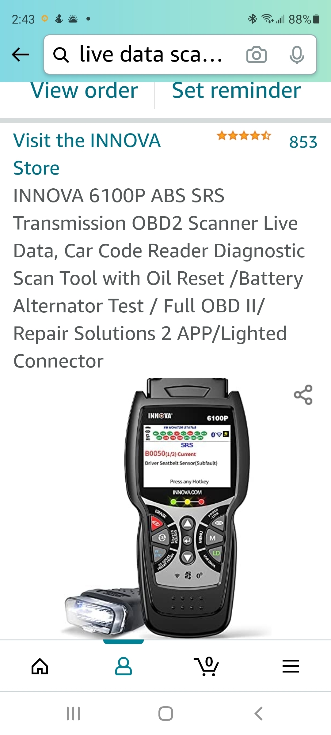

Will this scanner big good enough for live data?
Jul 14, 2021 at 8:32 AM
  • 110,248 POSTS
As long as it can read live data, it should do the job.
I don't know the price on that one, but take a look at the attached pic from Amazon. This scanner can do OBD2, live data, and Can-bus reading.
I never owned one like this, but I thought the ability to read the CAN is a good plus. The newer the vehicles get, the more it will be needed. It's just a thought. It may last you longer.
Let me know if I can help in any way.
