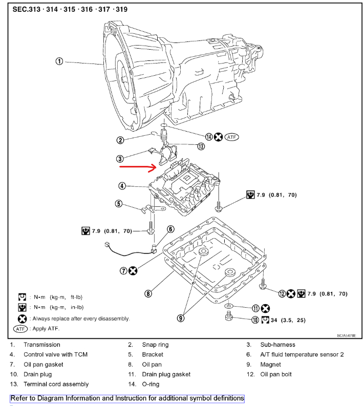

Trying to change neutral safety switch?
4.0L • AUTOMATIC
JACOB_1
trying to change nuetral safety switch
Sep 16, 2026 at 10:15 AM
JACOB_1
replace
the nuetral safety switch
Sep 16, 2026 at 10:57 AM (Merged)
  • 55,721 POSTS

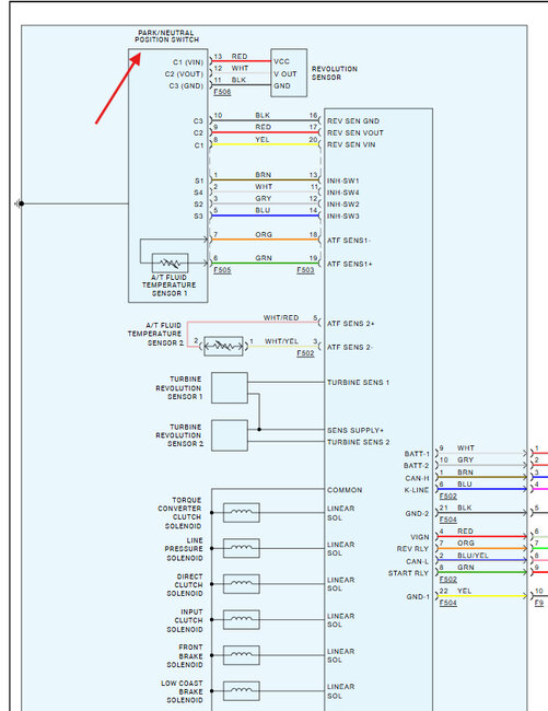

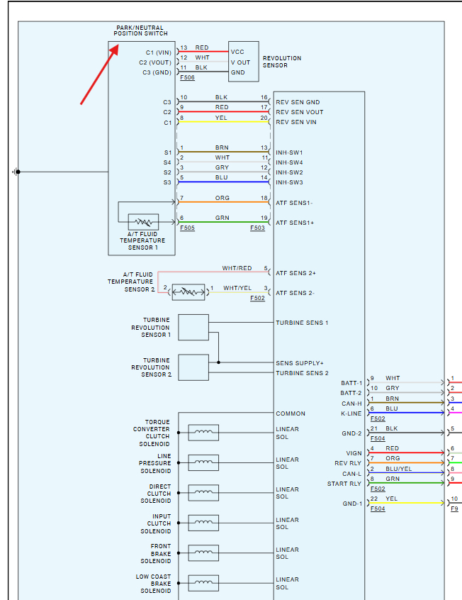

The neutral safety switch is referred to by Nissan as the Park/Neutral Position (PNP) switch or transmission range switch. It is mounted internally with the valve body, you must remove the transmission fluid pan to service it. Here is the wiring diagram for it so you can see.
