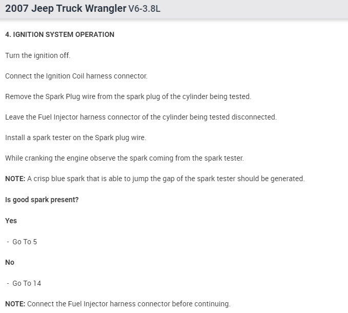

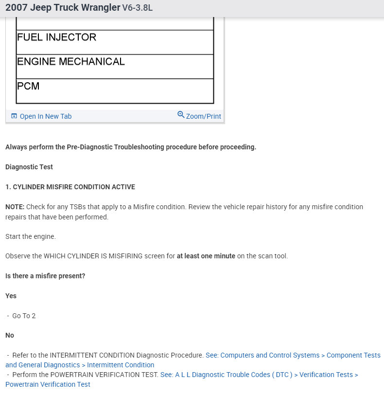

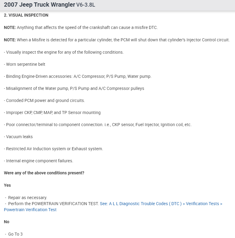

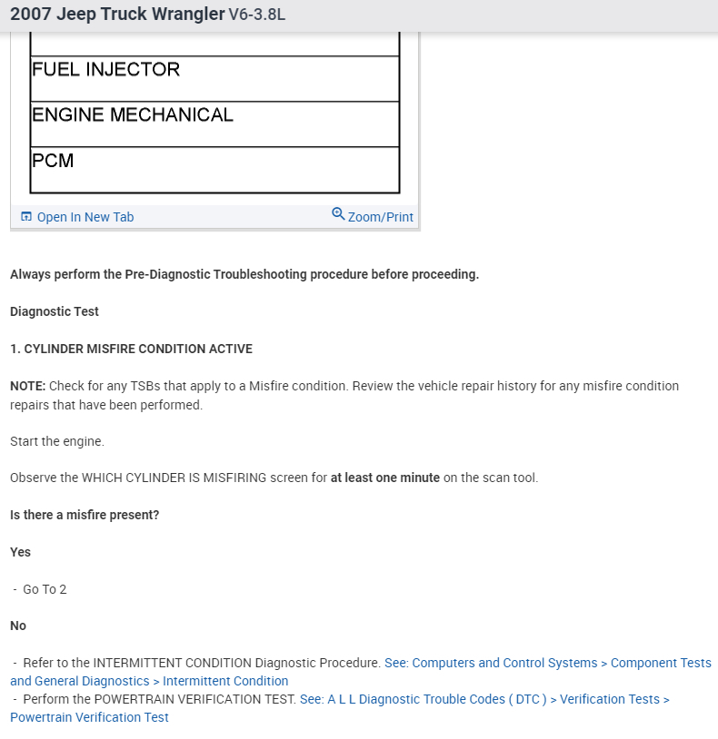

my motor misfires on 2 - 4 - 6, on a live test.
Jun 26, 2022 at 7:12 AM
SQM
  • 6,383 POSTS

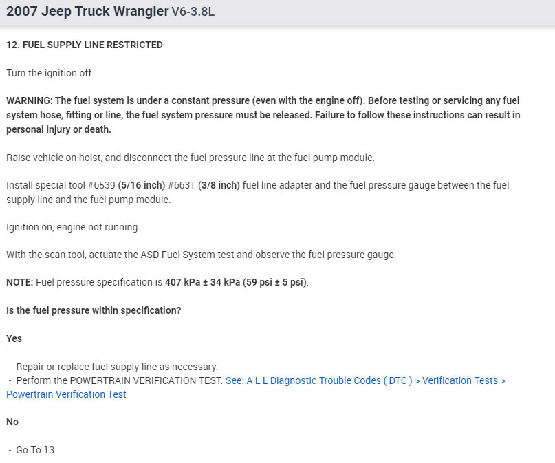

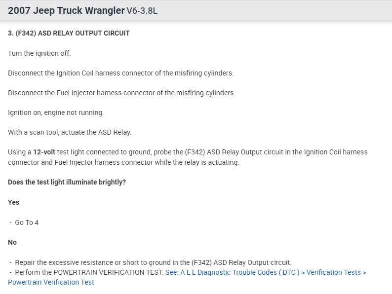

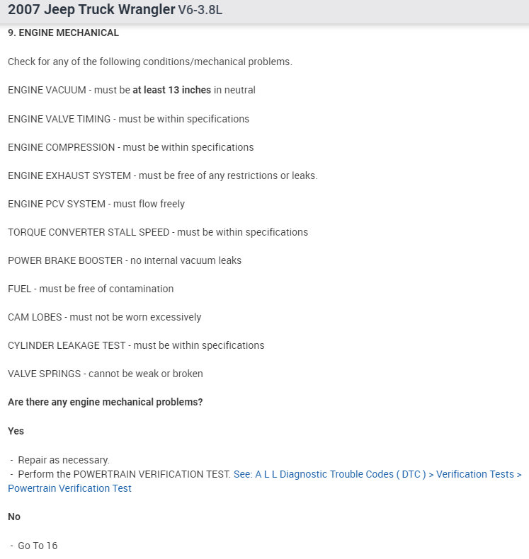

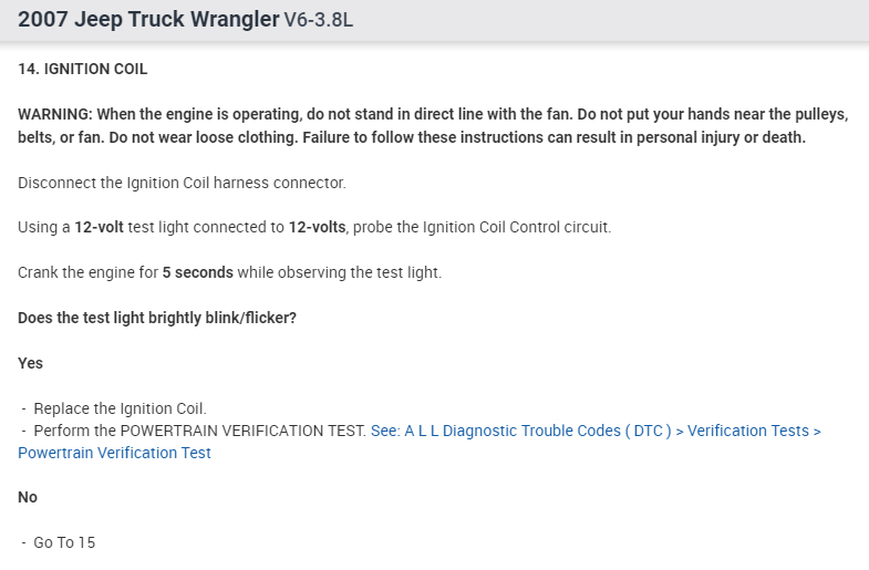

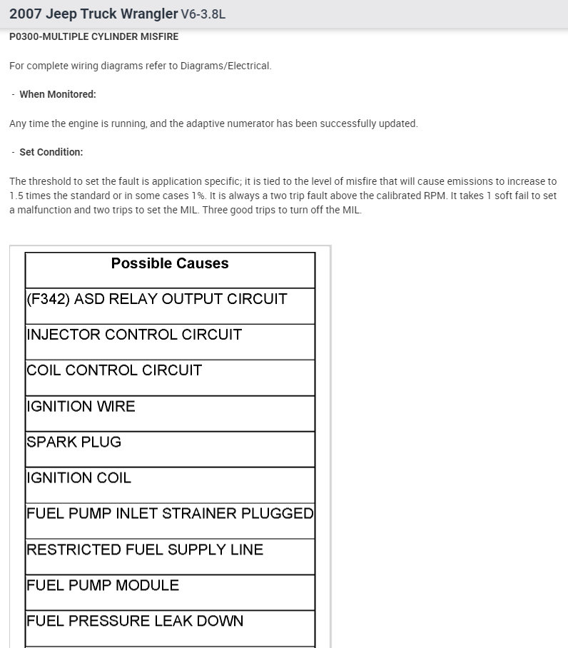

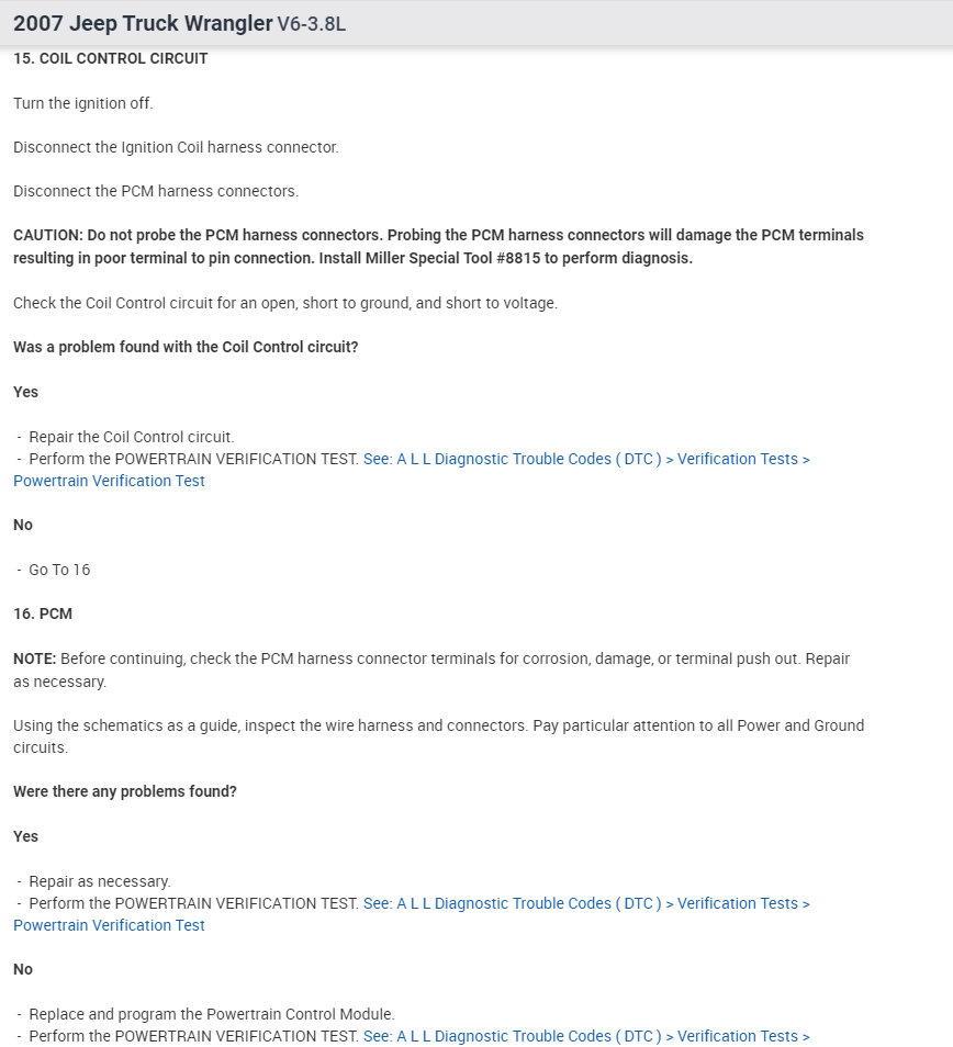

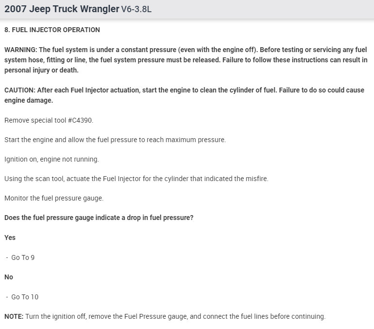

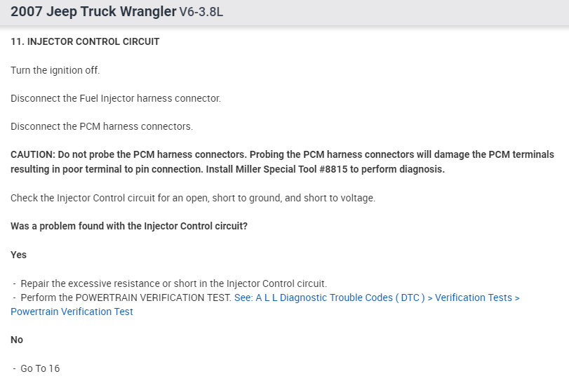

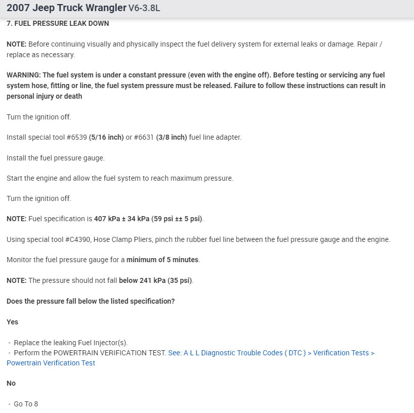

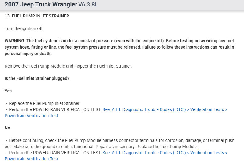

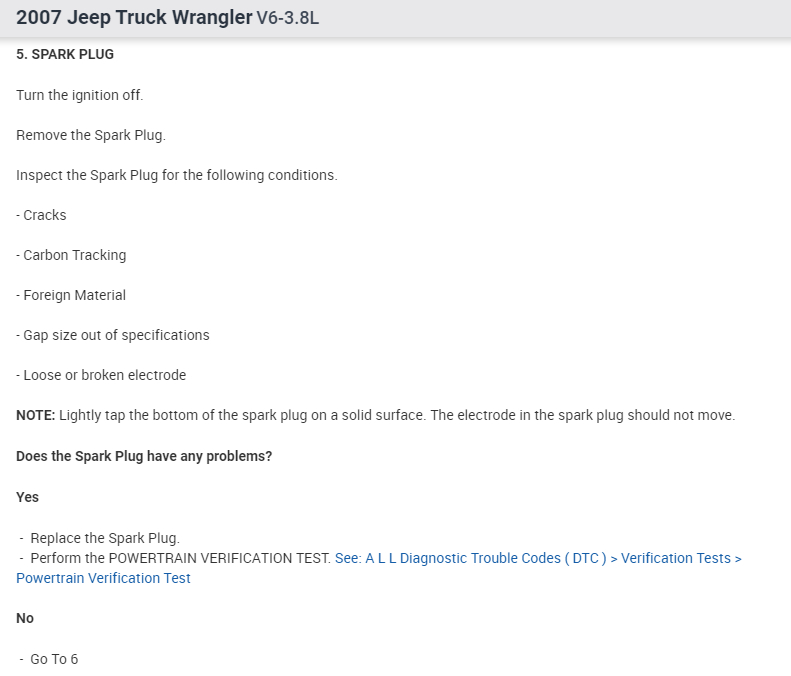

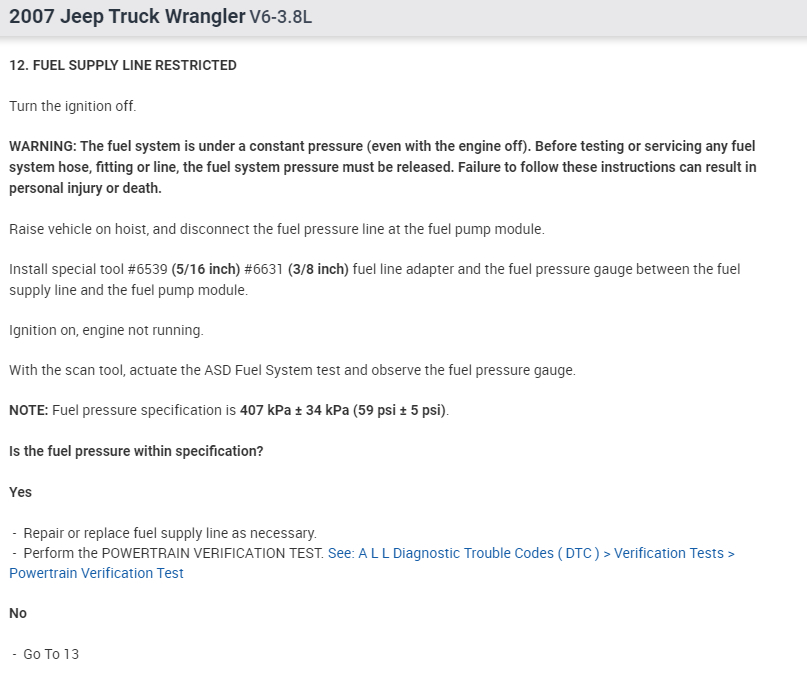

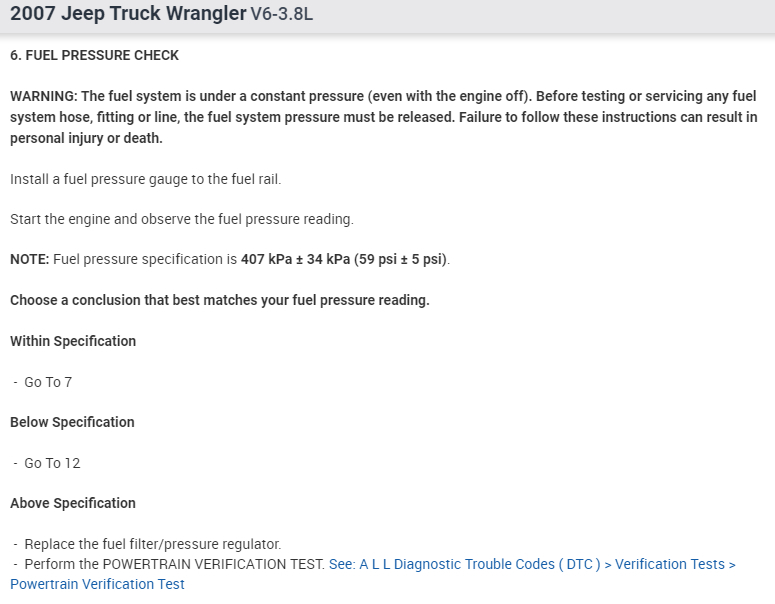

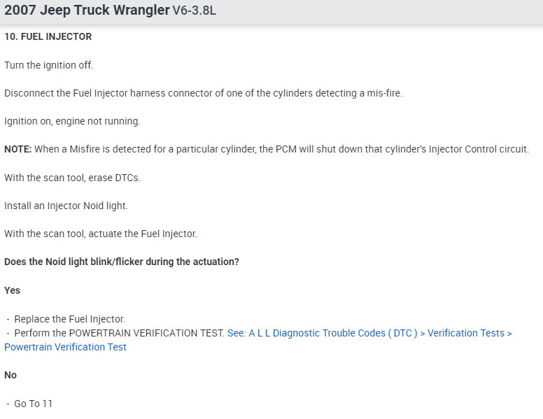

There are a number of reasons why you would get the P0300 code.
It could be due to worn spark plugs, bad coil, also could be for having improper fuel pressure, faulty injectors. It can even be due to a faulty PCM.
I have attached the troubleshooting guide for the code P0300 below for your reference.
It covers the usual diagnostics procedure.
Let me know of any questions.
