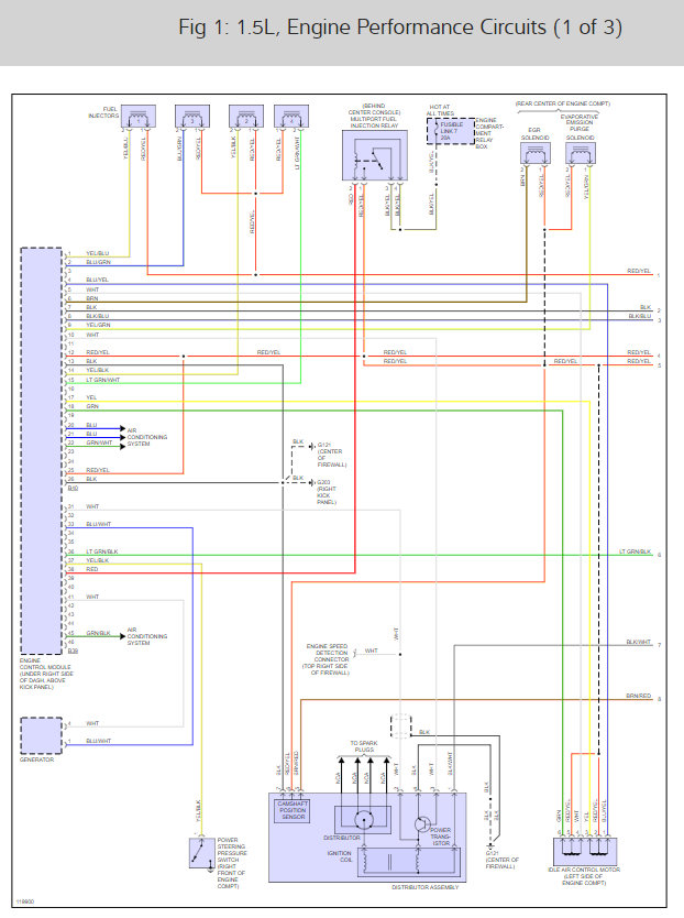

Cylinder one and four misfire, check engine light blinks on dashboard. Only two and three firing. Mechanic rule out compression, injectors, coil, spark plug. Also replaced valves and seal. Help anyone please.

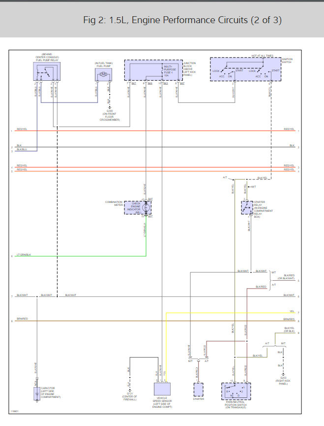

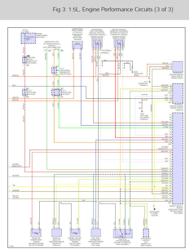

It sounds like you lost one of the coil drivers inside the PCM or the distributor is bad but to be sure lets check the wiring to the coil to confirm the failure.
Here are the engine wiring diagrams. Does this car have a distributor?

Thanks for your reply. Already change the driver module same result?

Did you check the wiring? Also, the driver module is inside the PCM did you change it out? If you can read the wiring diagrams I can give you larger ones.
