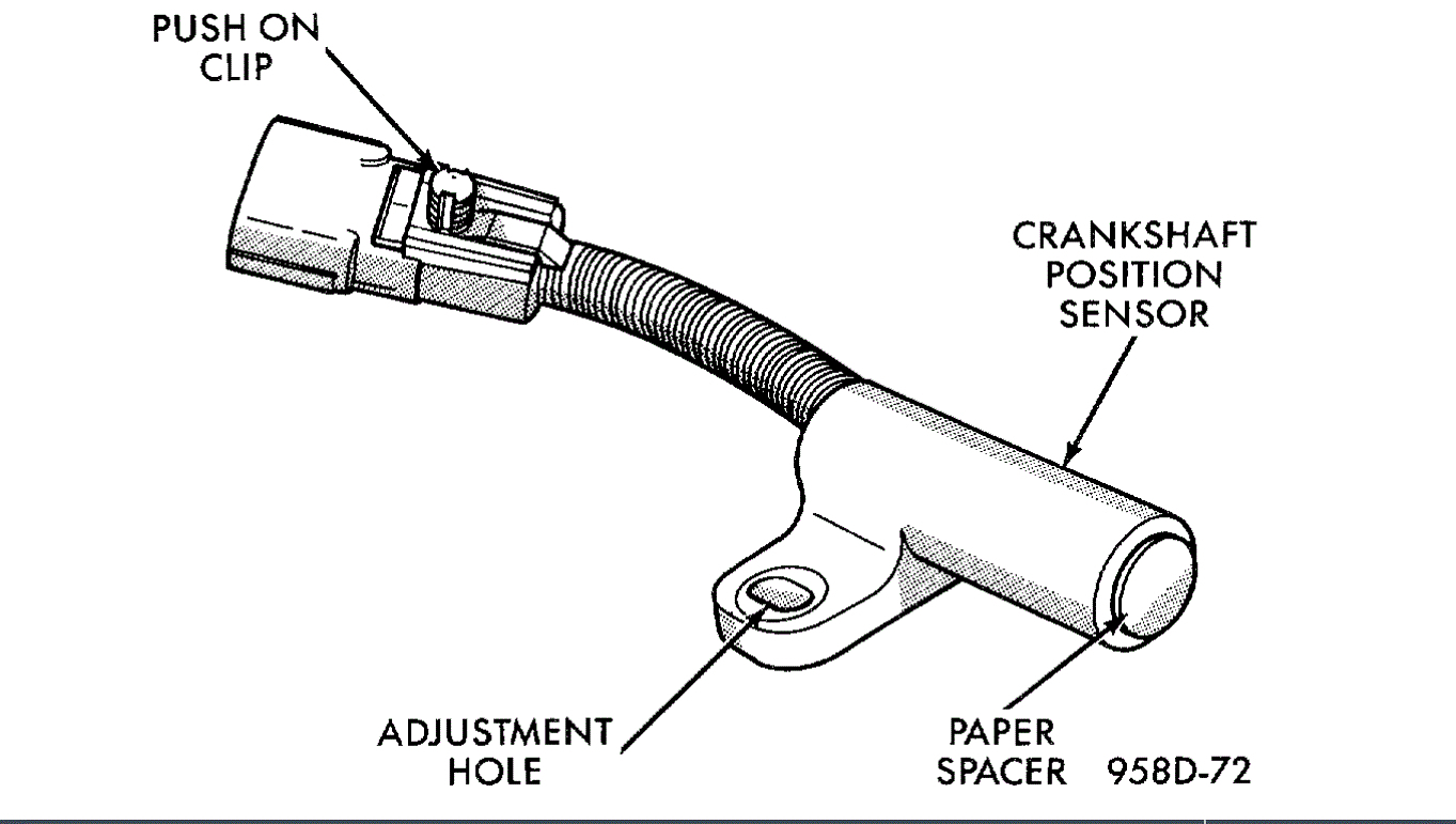

What you described sounds like a bad crankshaft position sensor. When they start to fail, heat will have an adverse affect on them. Take a look through these two links. The first one describes the sensor and the second describes common symptoms.
https://www.2carpros.com/articles/how-a-crank-shaft-angle-sensor-works
Let me know if the symptoms described in the link mirror what you experience. The sensor on this vehicle is located on the transmission bell housing, so I will give you directions for replacement if you want to give it a shot.
I did attach a pic of the sensor.

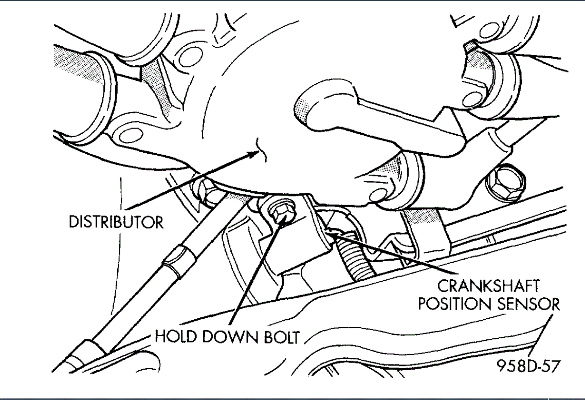

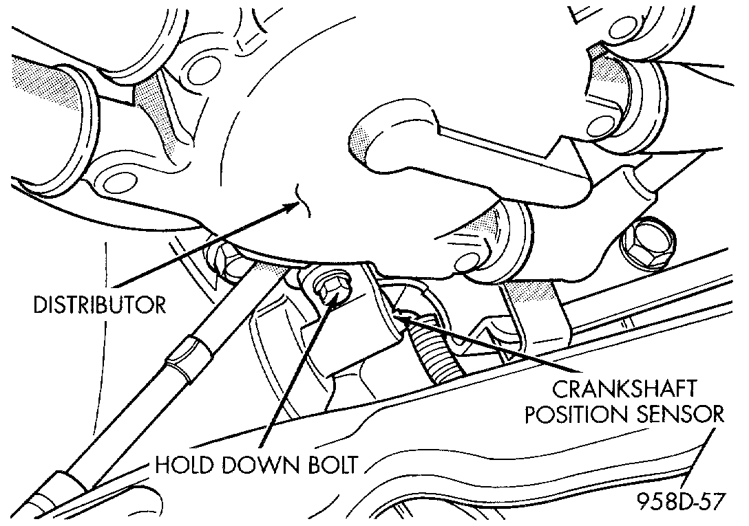

I know there is a paper spacer. Is that installed? Here are the directions from alldata. See if there is anything you are missing.
____________________________________
1999 Dodge Stratus V6-2.5L VIN H
Procedures
Vehicle Powertrain Management Sensors and Switches - Powertrain Management Sensors and Switches - Computers and Control Systems Crankshaft Position Sensor Service and Repair Procedures
PROCEDURES
pic 1
REMOVAL
1. Remove speed control servo from driver's side strut tower.
2. Remove crankshaft position sensor retaining bolt.
3. Pull crankshaft position sensor straight up out of the transaxle housing.
4. (Disconnect crankshaft position sensor electrical connector from the wiring harness connector.
INSTALLATION-ADJUSTABLE
All vehicles will be equipped with an adjustable crankshaft position sensor. This can be identified by an elongated mounting hole in the sensor.
Crankshaft Position Sensor And Spacer
pic 2
NOTE: If the removed sensor is to be reinstalled, clean oft the old spacer on the sensor face. A NEW SPACER must be attached to the sensor face before installation. If the sensor is being replaced, confirm that the paper spacer is attached to the face of the new sensor.
1. Install sensor in transaxle and push sensor down until contact is made with the drive plate. While holding the sensor in this position, install and tighten the retaining bolt to 12 N.m (105 in. lbs.) torque.
2. Connect crankshaft position sensor electrical connector to the wiring harness connector.
3. Attach connector to heater tube bracket.
4. Install speed control servo. Tighten nuts to 9 N.m (80 in. lbs.) torque.
If you did everything as described, I need you to get your hands on a live data scan tool. I need to know fuel trims when this is happening and I need the engine coolant temp sensor (ECT) reading when it's happening.

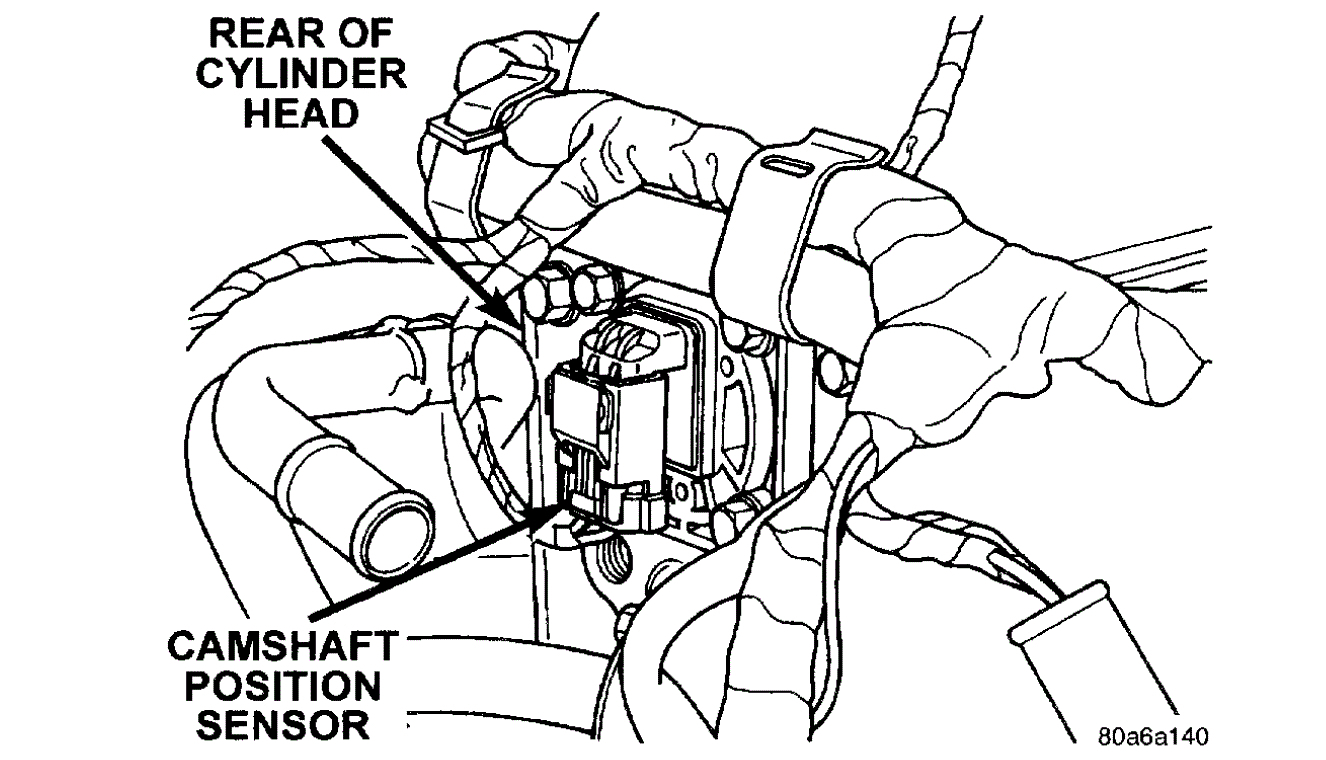

Greetings Joe, can't believe it's almost been a month already since our last message. Had another shop scope my problem, but they did not share fuel or ECT reads. However they did provide insightful info which relates to your last post on 8/18.
1. Concluded that it's either the sensor wiring or damaged reluctor wheel. I'm hoping for the former. My question to you today (well there's actually a couple, few in this reply) is if the reluctor wheel is damaged (and this could have occurred when they removed and replaced the trans-axle to fix freeze plugs), but if the RW is damaged, would I be having intermittent issues? I'm thinking if the RW is damaged it would be a consistent miss all the way from start-up through warm-up. If it ends of being the RW, is this something that can be removed and replaced? This latest shop said they wouldn't try it due to the sensitivity of removed and replacing that particular part.
2. I remember back when I first thought the no start was CKP related, and I removed and replaced the sensor, I had trouble freeing the plug where it was attached to the frame with those plastic threaded grommet studs (mounted to the sensor plug in this case). Fought it pretty hard and twisted and such to finally get it free. This is when I could have damaged the plug end that runs down from the main harness. At any rate, latest shop suggested I hard wire the CKP sensor (eliminate the plug). Do you recommend doing this, or should I re-pin that side of the plug? If I hard wire, how do I know which wire goes where between the two ends of the plug? Is there a chance of crossing wires?
I'm hoping once I get it missing again, at idle especially, I can reach down an manipulate the plug (squeeze, twist) to remedy the miss. Oh how sweet that would be to just be the plug!
3. One last consideration is the cam sensor in the new distributor. This latest shop was getting CMP sensor faulty readings, but they said they were ghost readings related to the faulty CKP signal. They said it most likely isn't the CMP sensor, but I may removed and replace since it's under warranty and much easier to do than the RW.
Thanks Joe, hope all out in CA is well.
Sep 12, 2020 at 11:04 PM
  • 110,240 POSTS
The idea that the original code was related to the cam sensor makes me question why they feel the way they do. The camshaft position sensors are on the rear of the cylinder heads. See pic 1.
As far as hard wiring the crank sensor, well lets just say that isn't something I like doing. It wouldn't be hard. Simply cut the wires one at a time and connect them the same way the connector had them.
I wonder why nothing was provided for the temp sensor. Maybe it was okay.

Good news Joe. The cam sensors on the 2.5L are in the distributor. Code P1391 says either cam, crank or reluctor wheel. Everyone including 2 scopes pointed to crank sensor.
Received savvy advice that failure of cam sensors in reman Chinese/Mex distributors is high.
Pulled used $25.00 distributor from Mike Gill's in Warsaw, IN, and it's been running strong ever since. Returned $200.00 defective reman to Advance Auto.
Really appreciate all your input and hanging with me through this. Sure am glad I didn't bypass plug.
