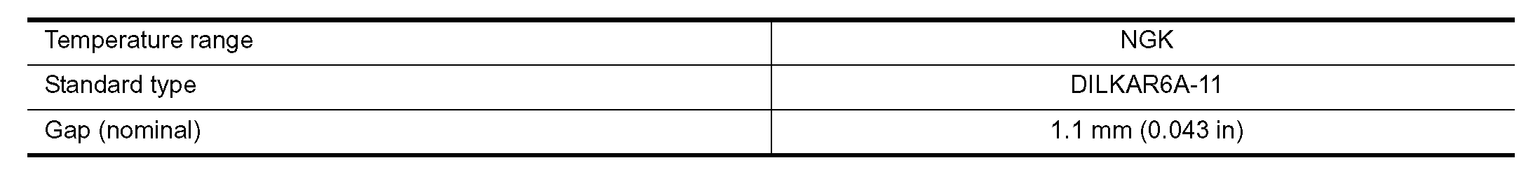

Here are the directions specific to your vehicle for spark plug replacement:
2007 Nissan-Datsun Altima L4-2.5L (QR25DE)
Removal and Replacement
Vehicle Powertrain Management Ignition System Spark Plug Service and Repair Removal and Replacement
REMOVAL AND REPLACEMENT
SPARK PLUG
Removal and Installation

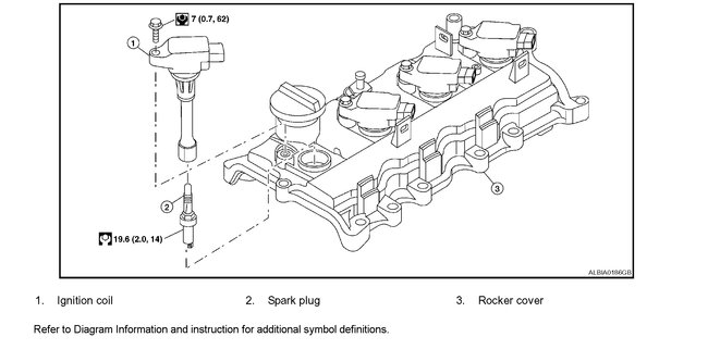

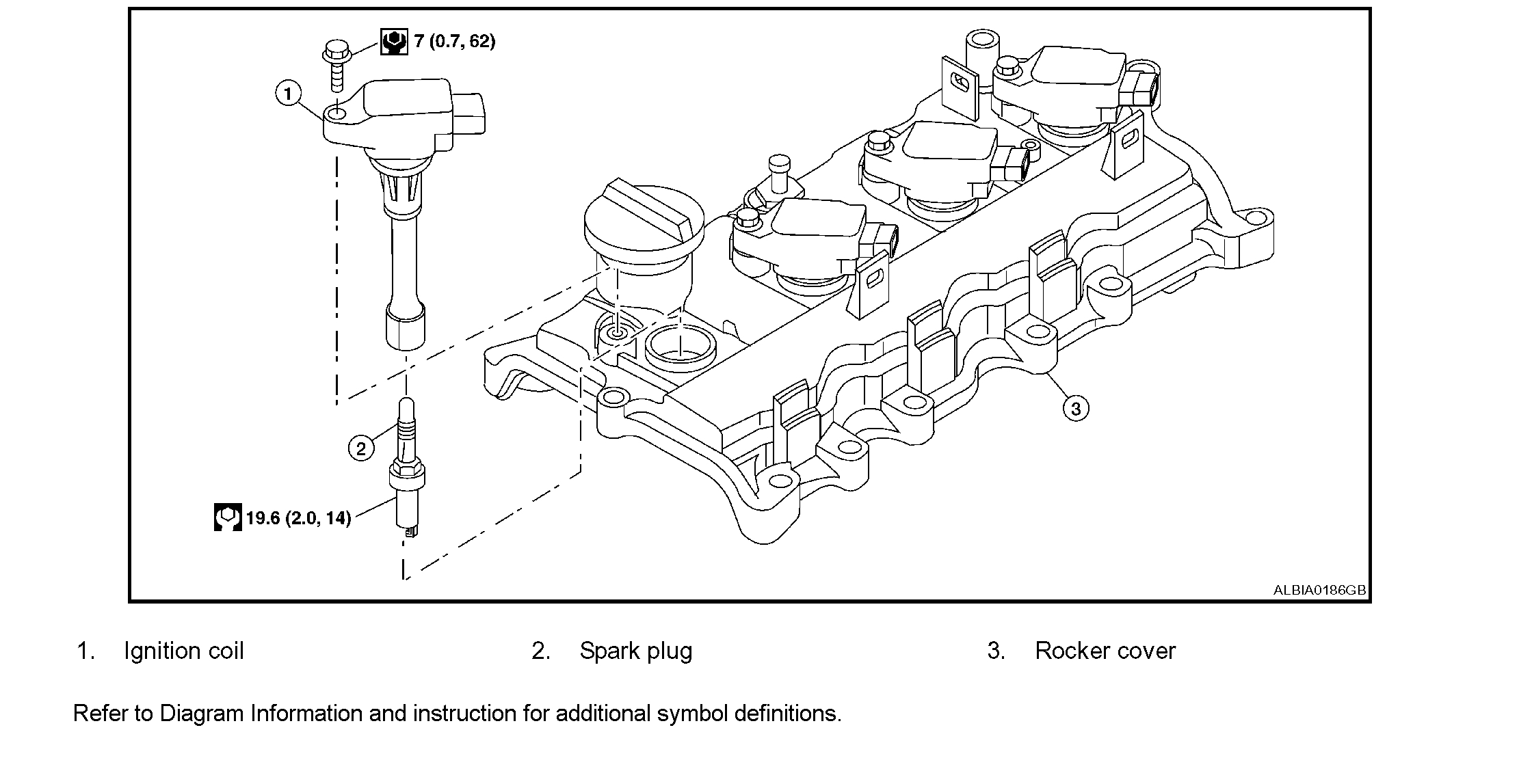

Exploded View EM-14
pic 1
REMOVAL
1. Remove the ignition coil.
pic 2

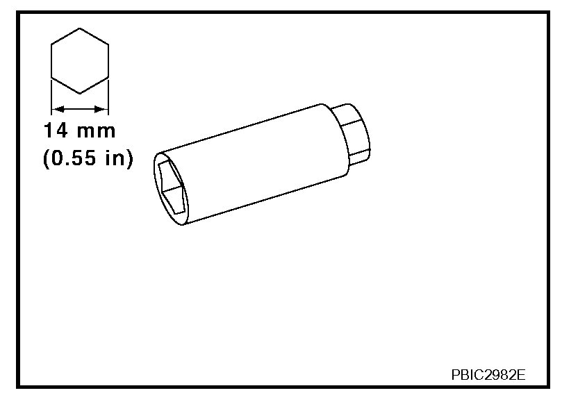

2. Remove the spark plug with a suitable spark plug wrench.
INSPECTION AFTER REMOVAL
pic 3

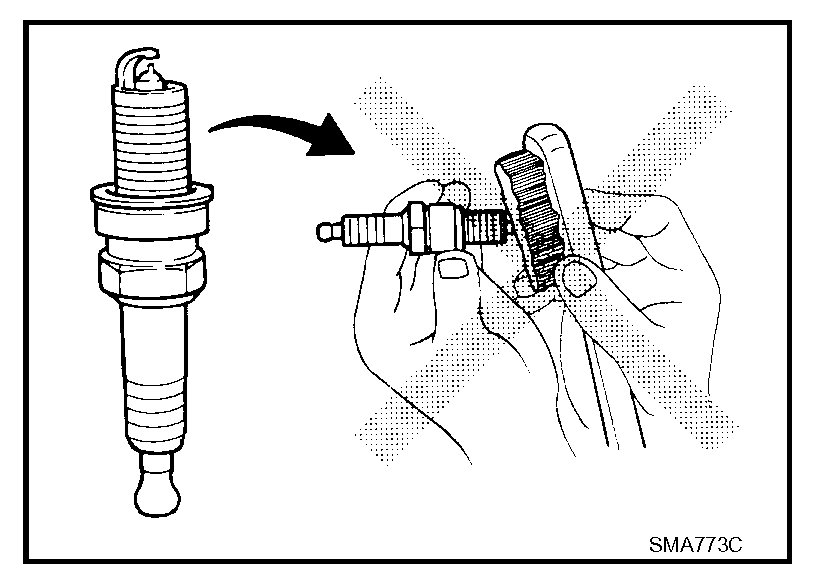

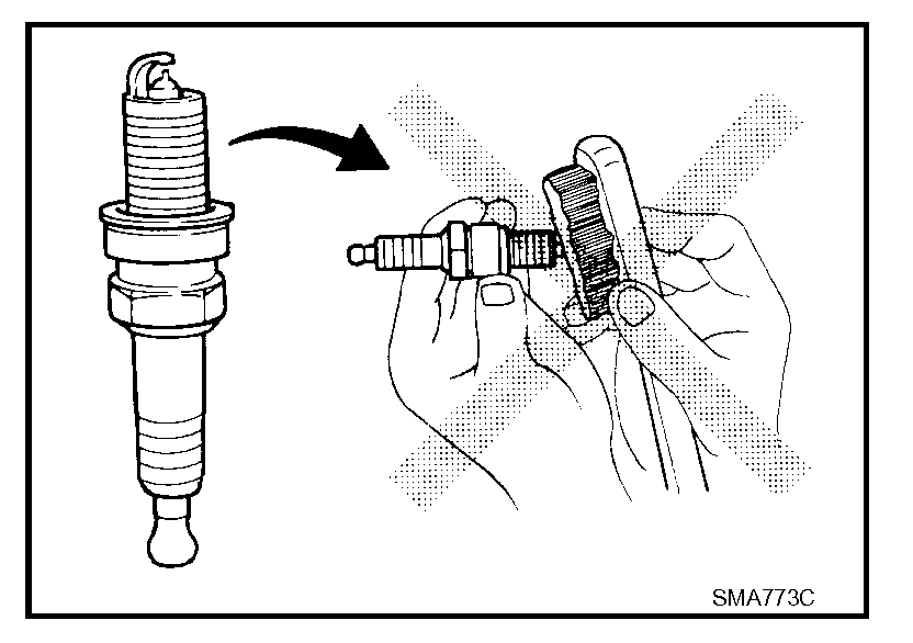

^ Do not use a wire brush for cleaning the spark plugs. Replace as necessary.
^ If plug is covered with carbon, a spark plug cleaner may be used.
Cleaner air pressure: less than 588 kPa (6 kg/cm2, 85 psi)
Cleaning time: less than 20 seconds
pic 4

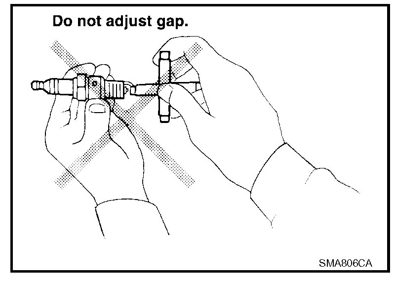

^ Checking and adjusting plug gap is not required between change intervals. If the gap is out of specification, replace the spark plug.
Gap (nominal): 1.1 mm (0.043 in)
INSTALLATION
Installation is in the reverse order of removal.

Joe thank..I changed all plugs... for 200k. They were beautiful...the coils all looked perfect.. .#2 coil has burn mark at the boot only coil that I can afford ...am I on the right track?I couldn't find anything.else...can I replace just one

No problem. I would recommend getting the spark plugs replaced. You got your money's worth from them. LOL
If the misfire continues, then switch the coil from cylinder 2 to a different one. Run the vehicle and see if the misfire changes cylinder. If it does, then you know it is the coil.
As far as codes related to a misfire, it's simple. You have a P0302 which indicates a cylinder 2 misfire. A P0301 is cylinder 1, a P0303 is cylinder 3, and P0304 is cylinder 4.
If you switch the coil from cylinder 2 to cylinder 1 and find a P0301, then you know the misfire has moved cylinders and the coil is bad.
Let me know what you find or if you have questions. Also, plan to replace all the plugs.
