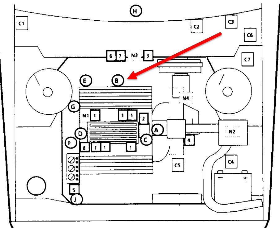

when attempting to drive, car starts missing real bad and blows black smoke was told prob a sensor. something about the fuel being too rich, but there are so many sensors how do I know which one? as you see the car is old and I cannot afford anything else. I cannot afford to play a guessing game with sensors either.

scan for codes A and B on diagnostic link below left side of steering column. then check fuel pressure with a gauge auto parts rent it. See link on where to connect. should be 41-47 psi it may be a regulator for fuel. get back to us with codes I do not think it is a sensor.

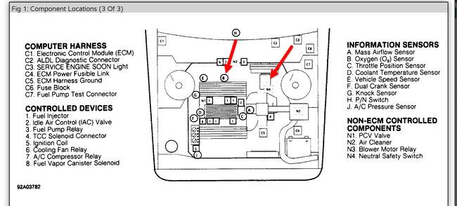

it came up code 13 , which is a 02 sensor ...correct ? but it doesn't say which one , there is more than one isn't there ?

and can you tell me exactly where these sensors are located please

the older models may only have one and it will be in front of converter. code 31 is a park /neutral switch which could be a bad switch or a short. it's located under shift lever on transmission

in my first reply I stated what the fuel pressure should be if not at minimum you have a bad fuel pump. code 13 is O2 sensor item b in pic and other is neutral switch item N4 in pic those are what your two codes are saying is wrong with car as well as you have a bad fuel pump. pump pressure should be checked with key on only.
