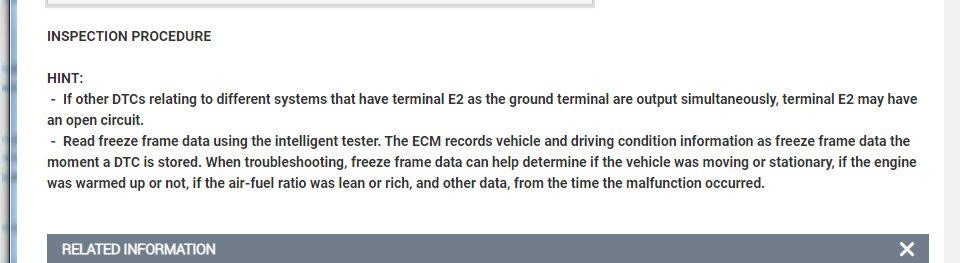

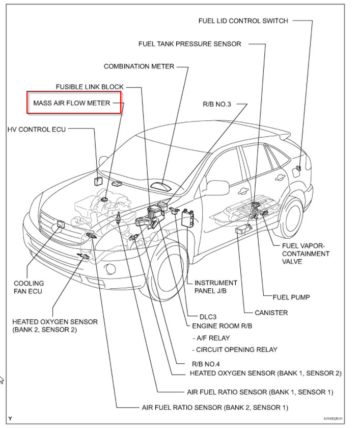

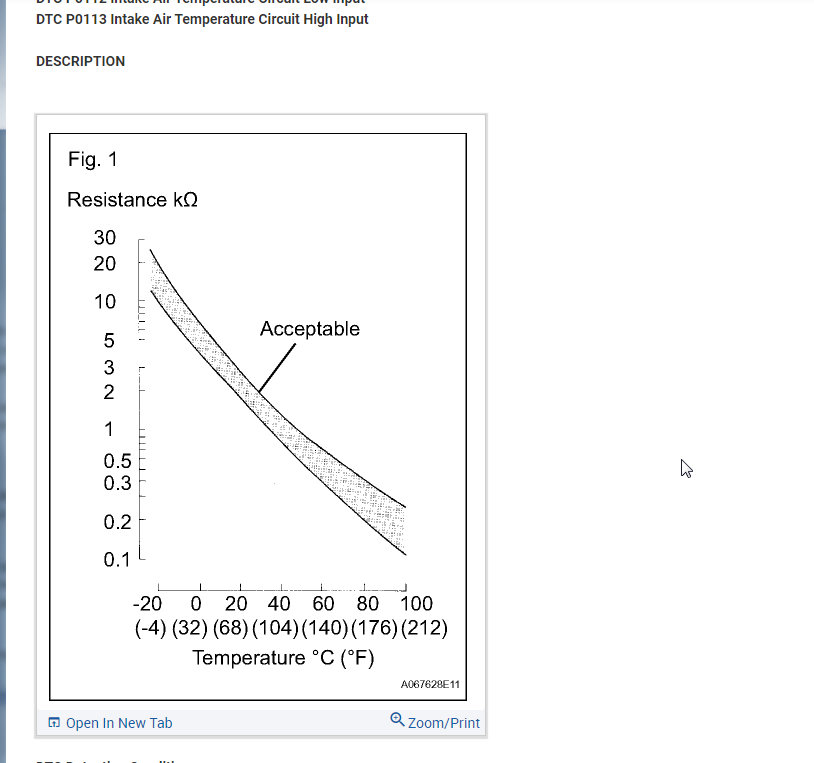

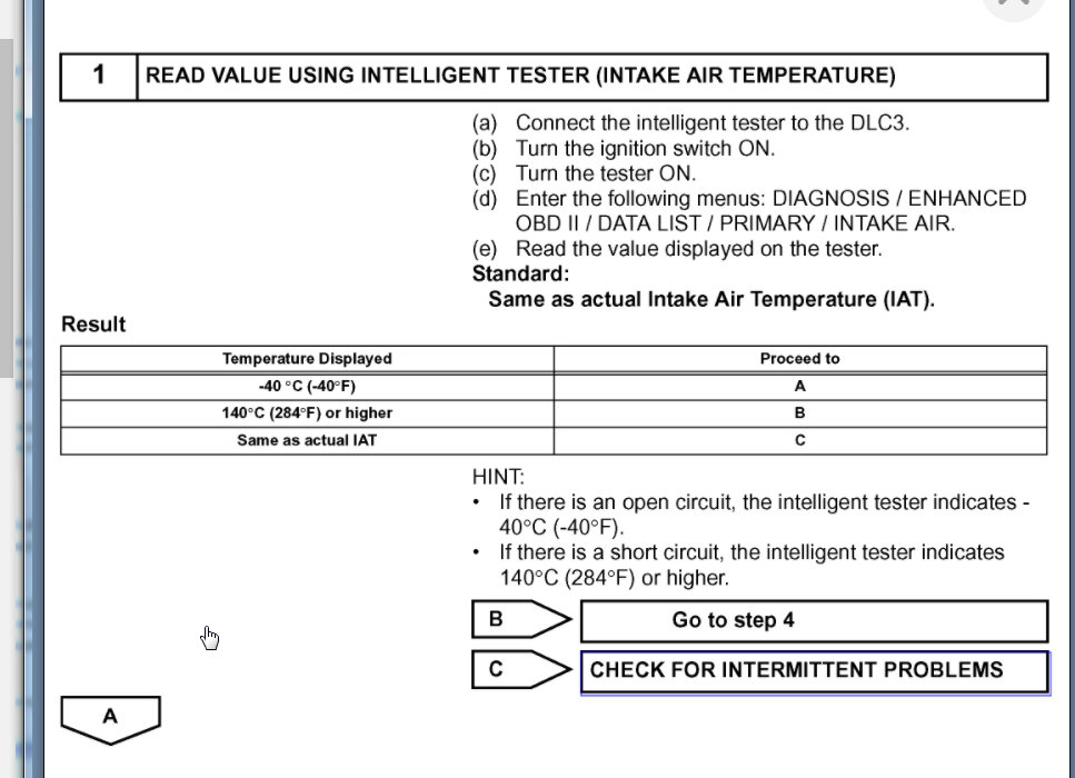

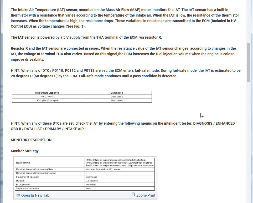

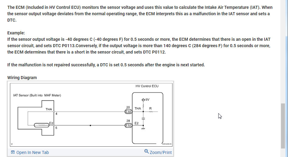

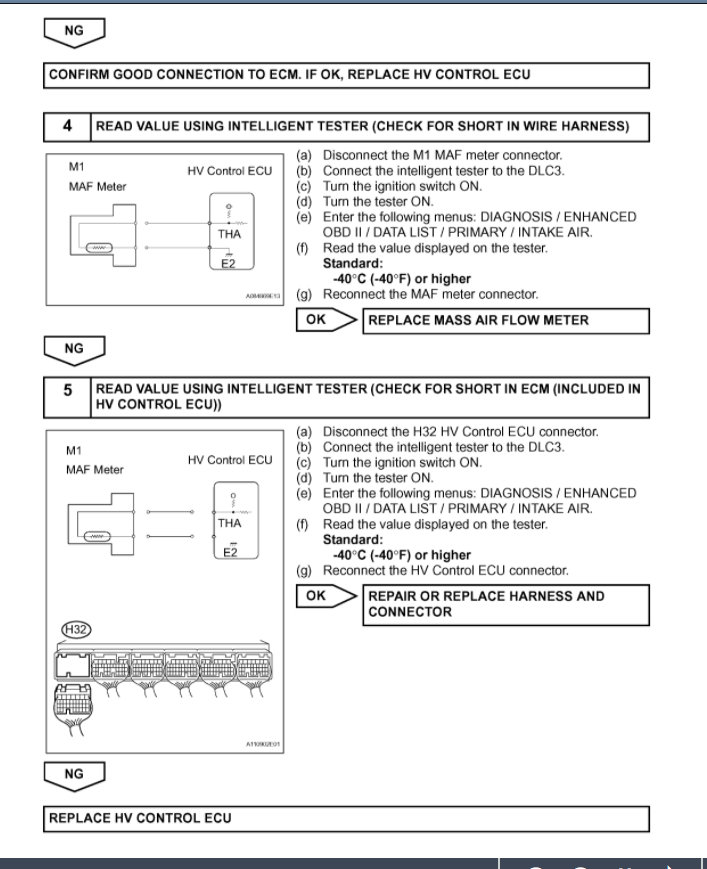

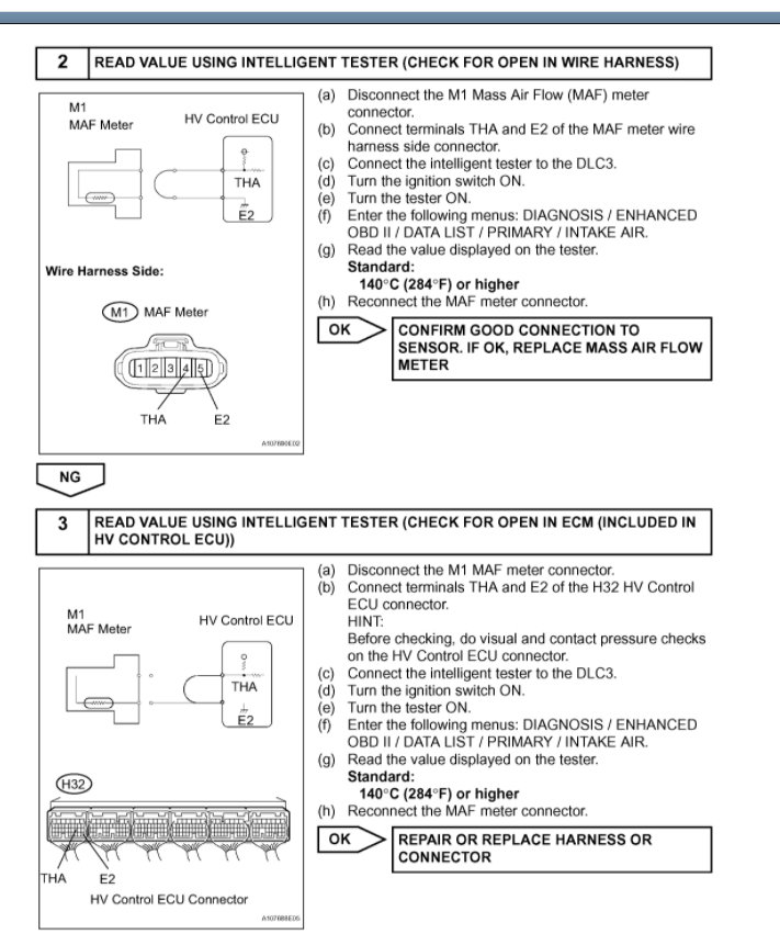

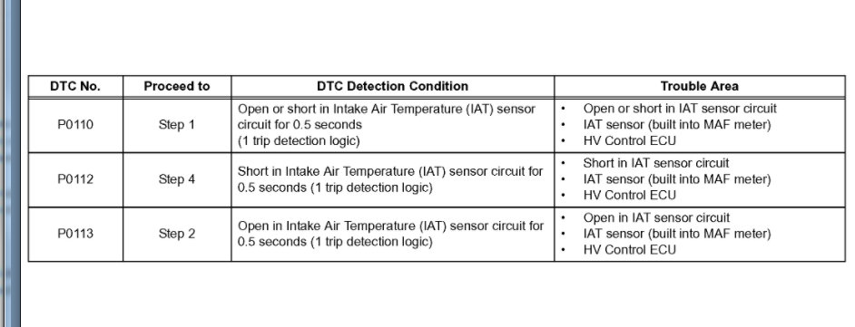

I attached the testing for the P0113. I think that will lead you to your issue. I suspect you have more chewed wires that you are just not finding. This would not cause a timing issue or any other mechanical issue so this is almost guaranteed to be more wiring issues.
Unfortunately these are not easy as you never know which wires they chewed on. So we just need to start somewhere and fix one thing and then keep going if that doesn't fix the other issues.
So I attached the testing for the intake air temp code because this is pointing to a wiring issues in the 5 volt reference wire. I would go through this testing and see what turns up.
Once you get rid of this code we will need to recheck what other codes are still there if any.

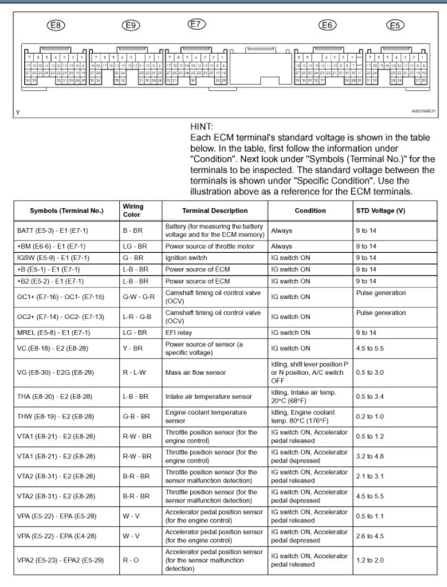

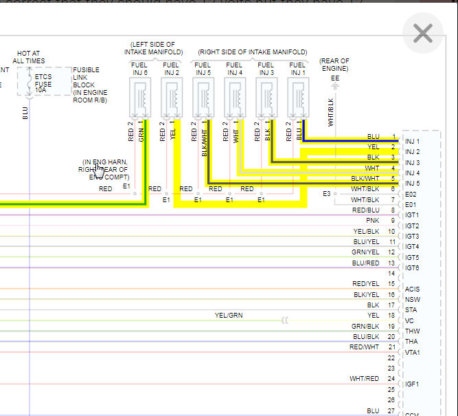

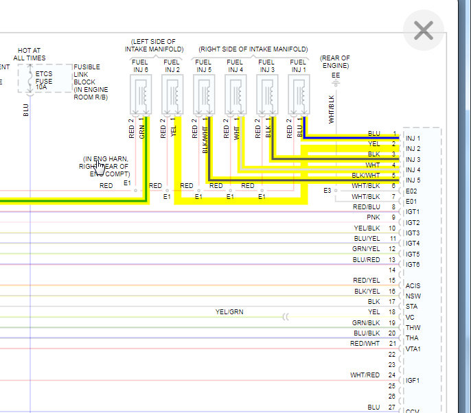

The short term bank 2 is + 20.3, sorry for the extra dash. Is the +20.3 okay? I pulled plug # 2 and it was dry, then I layered it with coil on engine and started engine briefly and saw spark. I checked fuel injector on cylinder 2 and have 11.47 volts going to it. I installed new injectors but didn't test them first ,not sure of voltage to use. Would 12v be okay? I'll need to remove intake manifold again to check cylinder number 1 plug and injector bummer. Can you get me a link to wire diagrams so I can check wires back to ECM. Thanks I appreciate your help.
Dec 11, 2020 at 12:48 AM
Okay. That helps. +20 is not good either. That just shows it is going the other way where the sensor is showing high oxygen content which means there is low fuel. So that would point to an air leak allowing too much air in (unlikely to effect just one cylinder) or the injector is not firing the proper amount of fuel. This could be due to a faulty injector or the ECM is not firing it.
Here is a guide on how to test an injector:
https://www.2carpros.com/articles/how-to-test-a-fuel-injector

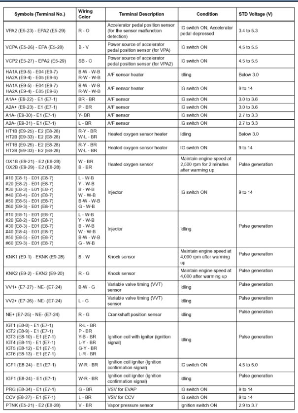

You are correct that they should have 12 volts but they have 12 volts all the time. The ECM supplies the ground which causing the injector to open.
I included the wiring diagram and the ECM pin out showing where these wires are. Let's test them using a test light as shown in the link or use a noid light. If the test light or noid light is lighting up then the ECM is grounding the injector correctly. Thanks

Thank you for the ECM wiring diagrams, I was able to get to injector #1 and test for pulse as well as #2 4 6 without removing intake manifold. I have no pulse on #2 injector. I did a continuity test back to ECM plug and the wires checked good. Would this indicate that the switch that controls the ground side of the circuit is bad and I need to change the ECM? If that is the case could you suggest my next step as far as finding another one and programming issues. Thank You
Dec 14, 2020 at 9:05 AM
Okay. If the injector is not firing but the others are and the wiring is okay then that would be an ECM issue. As for finding the part, I would just do an internet search as I am sure you can find a company that sells them already programmed. Even though this is a Lexus, it has Toyota software and they are pretty common to find already programmed so that you just have to install it.

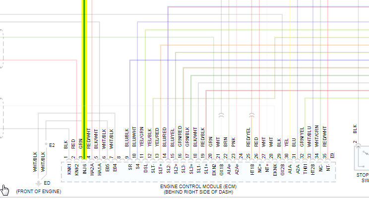

Thanks for your help! I think I figured out by using the diagrams you provided that the code 7E8 control module is terminal 7 on plug E8 at the engine control module. Terminal 7 is the ground for the pulse to the injectors. It looks like the switch that provides the pulse is not working.. I don't think it's repairable. Thanks again I don't think I would have gotten this far without your help. I'll keep you updated.

I have a question concerning the wiring from the ECM to the fuel injectors. I'm trying to test the wires from injector plug to ECM plug with both ends disconnected. I tested pins 1 thru 7 on ECM end plug and all 7 pins ran to ground. I can't see from the schematic you sent me on fuel injectors. why I'm reading to ground? I can't find schematics to show what else may be connected to allow this. I've purchased a replacement ECM , but I'm concerned about it being damaged if there is a problem. If you have any schematics that may show the path it would really help. Or if you have any other information or suggestions on how I can test for short to ground.
Dec 22, 2020 at 9:25 AM
The wiring diagrams that I provided above are the complete circuit from the injector to the ECM.
It is just a straight shot from injector to ECM. I am not sure if I am understanding how you are testing these but let me explain how they work and then you tell me if that makes your testing make more sense.
The injector is provided 12 volts on the red wire at all times the key is on. Then when the ECM wants to fire the injector it grounds the circuit on the other wire and the circuit is completed and the injector opens.
So in other words, it is an open circuit until the ECM wants to open the injector and the ECM provides the ground and the injector fires. So if you are testing the wire from the injector to the ECM for a short to ground. You should have ground if the injector is opening.
However, if you have disconnecting the injector and ECM and testing just the wire and you have a short to ground then you have a wiring issue.
If you have the ECM still plugged in and you are testing for a short to ground with just the key on and you have ground then the ECM is grounding the injector when it should not.
Let me know if I am misunderstanding something. Thanks
