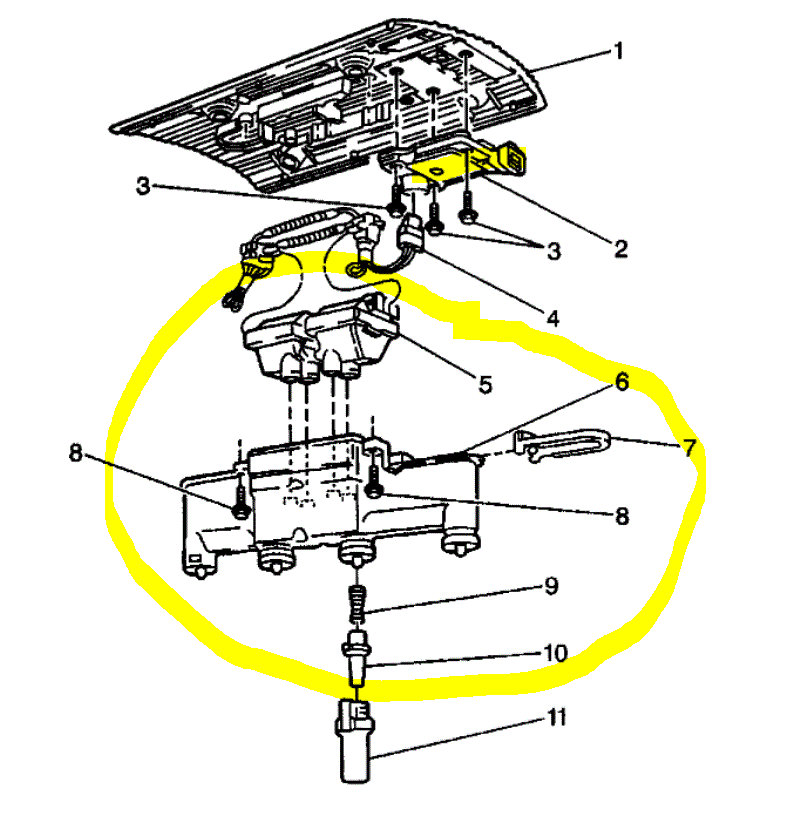

Cold compression all cylinders about 175. New plugs and coils check good. starts good but when warm cylinder four drops out.

Doug,
When this happens, have you checked to see if the cylinder has lost spark or if the injector has lost a pulse signal?
If you haven't, that is what needs to be done. What I suspect is happening is this. When the engine heats up, so does the ignition coil housing. Heat causes expansion when it comes to metal. I am thinking that the connection between the coil and coil housing for cylinder 4 is being lost. Recheck where they are connected to see if there is any excessive play or clearance.
See pic 1 below.
Let me know what you find.
See pic below.
