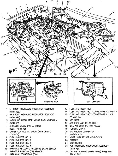

Engine runs rough under load (sitting at light with foot on brake or while accelerating). checked plugs and found oil in the well for cylinder one. Has contaminates in coolant as well.

If the spark plug wire is contaminated with oil, there is a chance it has deteriorated and is the problem. Try cleaning the oil from cylinder 1 and replacing the wire to see if that changes things. Also, I would also recommend removing that spark plug to confirm it is still good.
Now, what do you mean there is contamination in the coolant? Is the evidence of motor oil? Is there any coolant in the motor oil?
Apr 19, 2019 at 8:55 PM
MIKE HATFIELD
Thanks Joe. I’ve cleaned out the plug well and replace all the o-rings and valve cover gasket. The plug is new also and in good shape, no gunk or scorching. Had the oil changed today and they told me the coolant has contaminates. No coolant in the oil. Engine light is on and code said misfire in cylinder number one.

The only thing we can do is this. Since we know cylinder 1 has a misfire, the plugs are new, and you eliminated the oil leak, we have to look at three things. First, is the distributor cap in good condition, free of corrosion or cracks? Next, did you replace the number 1 spark plug wire? If all of those things are good, next we need to check for a fuel injector pulse and if there is one, we need to check engine compression. For an engine to run, it has to have those things.
So, first reconfirm there is a good hot blue snapping spark to the plug.
Okay, if you do have a good spark, then I need you to check for an fuel pressure and for an injector pulse. Basically, you are checking to make sure the fuel injector for that cylinder is getting power. Here are links showing how that is done:
https://www.2carpros.com/articles/how-to-test-a-fuel-injector
Make sure to follow the directions for the fuel injector test. I attached a picture of the engine to help you locate components. (picture 1) Number 6 in the picture is injector 1.
Now, if the fuel injector is working and you have a good spark, we need to check how much compression that cylinder is producing. If it is low, it will cause a misfire.

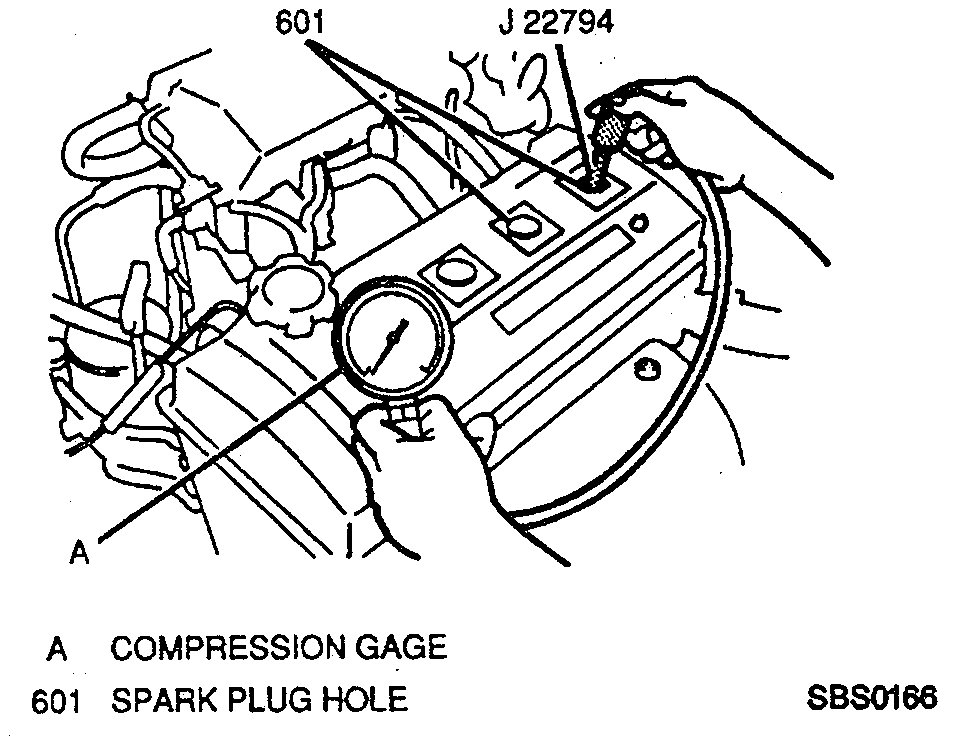

The links I attached are for general information and directions. Here are the specific directions for testing fuel pressure on your vehicle. Picture 2 correlates with these directions.
FUEL SYSTEM PRESSURE TEST
Pic 2

A fuel system pressure test determines if the fuel delivery system is functioning correctly from a fluid (gasoline) perspective. To perform this test, follow the procedure below.
1. Relieve the fuel system pressure. Refer to Fuel System Pressure Release Procedure.

9. Using a fused jumper, jumper terminals Fp to +B on the under hood DLC.
10. Turn the ignition switch to the ON position and allow fuel pressure to build.
MEASURE
^ The fuel pressure should be 265-304 kPa (38-44 psi). If pressure is higher than the specifications, check for a plugged fuel return pipe/hose. If pipe/hose are OK, replace the fuel pressure regulator. If pressure is lower than the specifications, check for leaks at hose-to-pipe connections, a leaking fuel pump or fuel pressure regulator. Repair/replace as necessary.

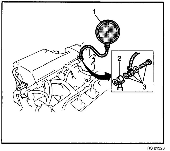

Here are the specific directions for testing engine compression. Picture 3 correlates with these directions.
COMPRESSION TEST
Pic 3
DESCRIPTION
A compression test is one of the best tools to assist a technician in properly diagnosing valve or piston faults and poor engine operation. To accurately determine the compression pressure, the throttle must be wide open, all spark plugs must be removed and the battery at or near full charge. Test each cylinder four times.

1. Stop engine.
2. Remove all four spark plugs and disconnect secondary (coil) wire from ignition coil. Refer to Ignition System.
3. Install a J 22794 and a compression gage into a - spark plug hole.
4. Disengage the clutch (manual transaxle equipped vehicles) to lighten starting load on the engine and depress the accelerator pedal to the floor (wide-open throttle).
5. Crank engine (with a fully charged battery) to take four pressure readings. Obtain an engine speed of at least 250 rpm or more. Record all four readings.

1. Normal operation-If the cylinder compression pressure builds up quickly and evenly to the compression specification (1,320 kPa/191 psi at 250 rpm), the pistons, pistons rings and valves are operating normally.
2. Piston rings faulty-If the cylinder compression is low on the first stroke and tends to build up on following strokes (but does not reach the compression standard), the probable cause is the piston rings are faulty. The addition of a small amount of oil through the spark plug port should improve the compression pressure considerably.
3. Valves faulty-If the cylinder compression is low on the first stroke and does not build up on following strokes, the probable cause is that the valves, valve seats or a gasket are faulty. The addition of oil does not significantly improve the compression pressure.
4. Faulty gasket-If the cylinder compression on both of any two consecutive cylinders (1-2, 2-3 or 3-4) is low and does not reach specification, the probable cause is a blown head gasket between the cylinders, allowing compression to leak between cylinders.
