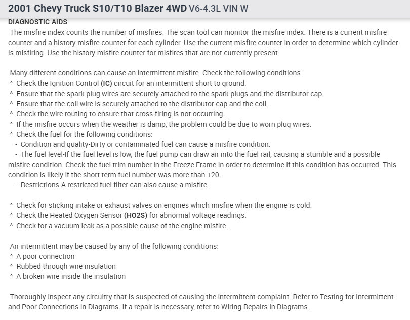

i have an engine code of po300 which is a random misfire and cannot find what is causing the misfire. I have changed the plugs, wires, cap, rotor and coil. what could it be that I'm not seeing?
Jun 24, 2022 at 10:44 PM
SQM
  • 6,383 POSTS

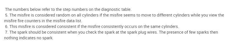

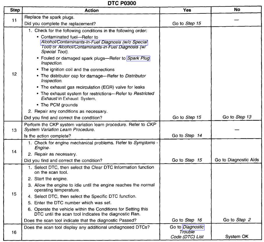

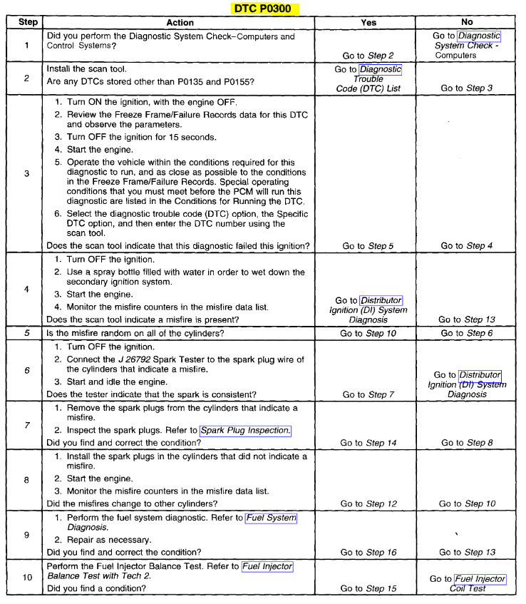

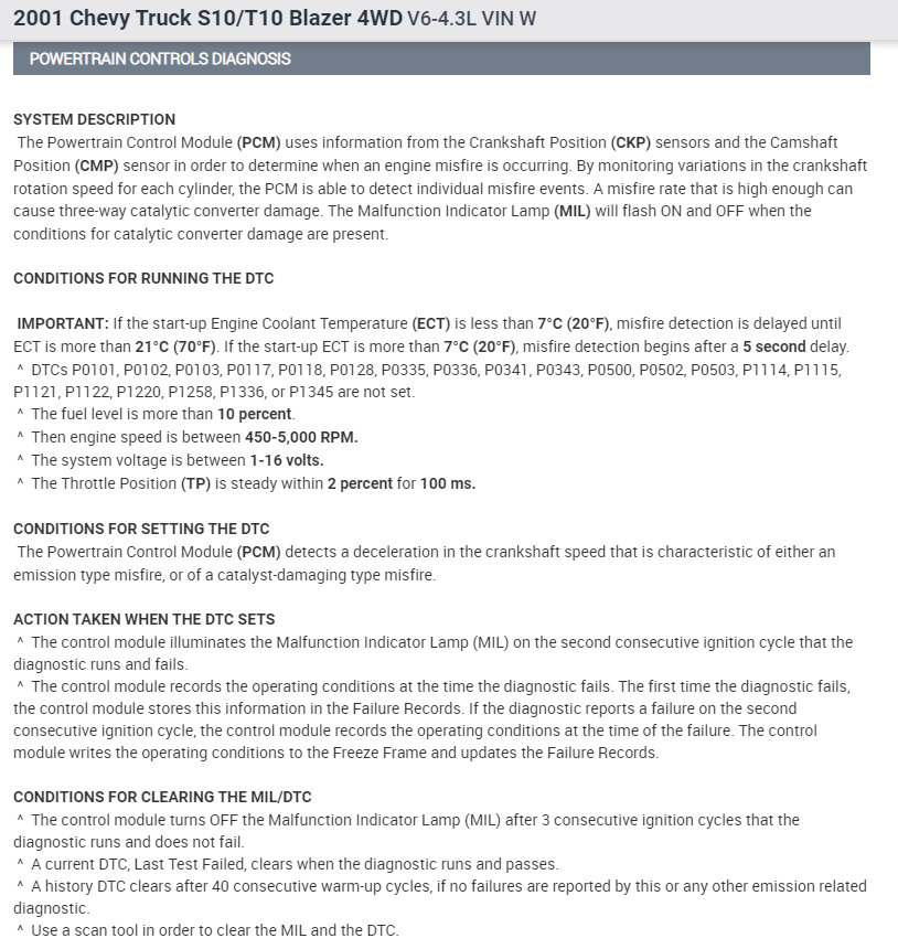

The P0300 can also get triggered due to faulty injectors among other things.
Take a look at this helpful guide:
I have attached the troubleshooting guide for the code P0300 below.
Follow those steps as it can help you determine the issue.
Let me know of any questions.
