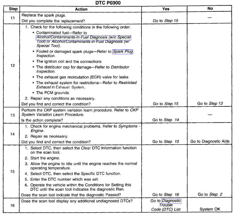

i have an engine code of po300 which is a random misfire and cannot find what is causing the misfire. I have changed the plugs, wires, cap, rotor and coil. what could it be that I'm not seeing?

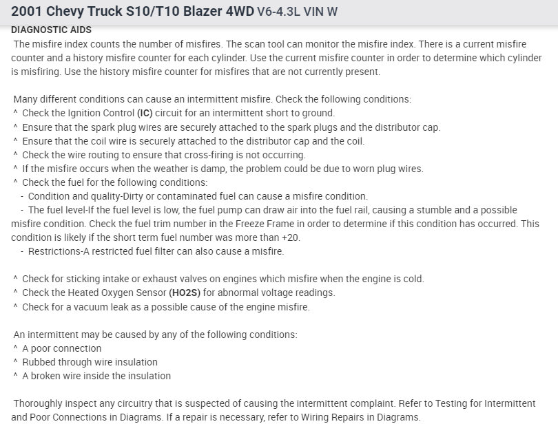

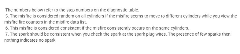

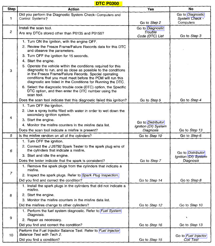

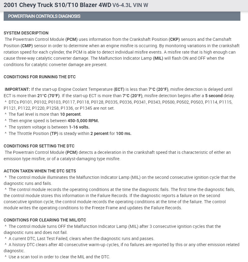

The P0300 can also get triggered due to faulty injectors among other things.
Take a look at this helpful guide:
I have attached the troubleshooting guide for the code P0300 below.
Follow those steps as it can help you determine the issue.
Let me know of any questions.
